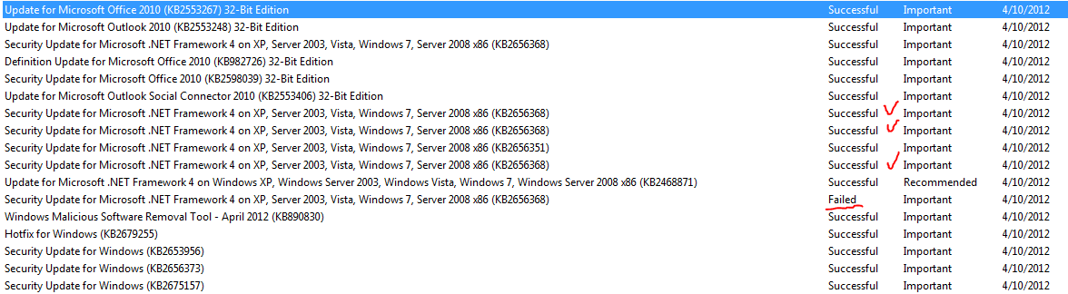

New update just popped out KB2656368
Thanks in advance!
Edit:
I tried to update your existing addon via WU and (again) it fails; error Code643 it downloads fine but wont install it.
And the same thing happened with previous version. Everything works fine, only problem is it wont update.
Edit 2:
After that I ran again check for updates and KB2468871 popped out! so I "ticked" this one and.... both were installed successfully, weird?
Edit 3:
Now KB2656351 popped out, so I ran it, reboot my lappy, checking for updates and KB2656373 showed up again! ...so I clicked "Install", it saying "The updates were successfully Installed" .... I'll restart it again and post back.
Nope, KB2656368 still in WU, even though it says installed few times, lol
post-2052-0-65429600-1334097590_thumb.pn
