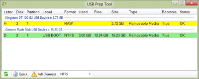

Legolash2o Posted August 15, 2011 Posted August 15, 2011 (edited) The 'USB Boot Prep' tool let's you prepare your USB stick so that you can install Windows Vista/7 from it, your computer does require support to boot from USB for the USB stick to work.Caution: The 'Full (Format)' button will format everything on the USB stick. W7T will ask if you're sure though.Yellow: Usually means it is RAW and has not been formatted, not bootable.Green: This means the drive is already bootable.Step 1: Plug in your USB stickThis tool won't work without a USB Stick so go ahead and insert one.Step 2: Select your stickHopefully W7T will detect your stick and list it, select the disk/partition you want to be bootable and click start.Step 3: Select Quick or FullQuick: This will just mark the partition as 'Active' and convert it to NTFS if needed.Full: This will 'Clean' the USB stick remove all partitions and data.W7T will work it's magic and let you know when it's done, once done you just need to copy and paste your installation files onto the USB stick. Edited March 28, 2012 by Legolash2o jorgen, Rek1t, osman fatih and 2 others 5 Quote

Legolash2o Posted October 27, 2011 Author Posted October 27, 2011 (edited) Sorry for the late reply i hardly read anything in this sub-forum, i'm sure it can be added to W7T quite easily.EDIT: Just press the 'Quick' button on USB Prep Tool, it doesn't format it. Edited October 27, 2011 by Legolash2o Quote

bluesmoke Posted March 18, 2014 Posted March 18, 2014 The 'USB Boot Prep' tool let's you prepare your USB stick so that you can install Windows Vista/7 from it, your computer does require support to boot from USB for the USB stick to work.Caution: The 'Full (Format)' button will format everything on the USB stick. W7T will ask if you're sure though.USBBoot.pngYellow: Usually means it is RAW and has not been formatted, not bootable.Green: This means the drive is already bootable.Step 1: Plug in your USB stickThis tool won't work without a USB Stick so go ahead and insert one.Step 2: Select your stickHopefully W7T will detect your stick and list it, select the disk/partition you want to be bootable and click start.Step 3: Select Quick or FullQuick: This will just mark the partition as 'Active' and convert it to NTFS if needed.Full: This will 'Clean' the USB stick remove all partitions and data.W7T will work it's magic and let you know when it's done, once done you just need to copy and paste your installation files onto the USB stick.thanks for tool but where is downlaod link Adem2808 1 Quote
wela Posted August 13, 2014 Posted August 13, 2014 (edited) HiI have a Prob with a new USB Stick. After inserting the Line was yellow Filesystem "Fat32", Bootable "False", Status "False". Ater clicking "Quick" the Line turn to "green", Filesystem "Fat32", Bootable "True" but the Status is "False". A test PC did not find a bootable device. Any idea why? :doh: I did not change Biossettings. Edited August 13, 2014 by wela Legolash2o 1 Quote
tony26 Posted September 7, 2014 Posted September 7, 2014 all you did was to make the drive activeyou need to put so type of boot files on the drive Quote
son goku Posted February 17, 2015 Posted February 17, 2015 Hello, Does the Quick option in this "USB Boot Prep" in this tool supports booting and installing in native UEFI mode (provided that the install.wim is under 4GB)? Quote
Legolash2o Posted February 19, 2015 Author Posted February 19, 2015 No it currently doesn't. v2 will though since I now have a UEFI computer to test it on Quote
