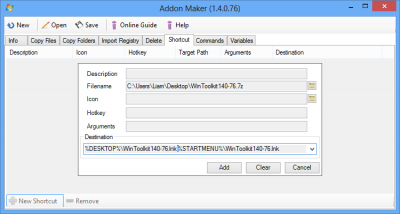

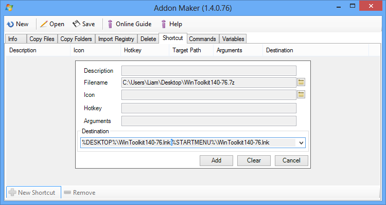

Just so you know, you can now have the same file going to multiple destinations if you split each pack with a '|' (straight back/forward slash not a capital i)
