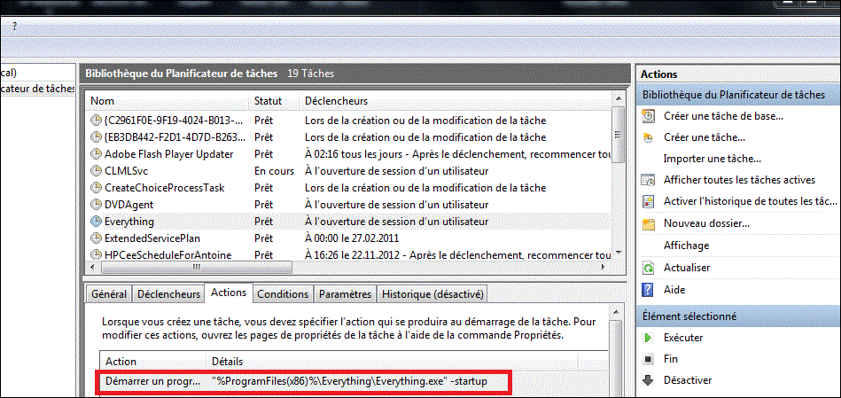

If there is some trouble with the batch file on Windows 64-bit, we can use this one instead (improved).
Tested on my computer 64-bit and the task is installed on the Task Scheduler.
Works on x86 and x64.
Everything_Schedule.bat

Hi myselfidem
Tested your script on Win7 X64, it don't works:
If i run the bat, it says "le lecteur spécifié est introuvable"
If i copy the content of the batch and paste it in cmd, the script is working but the task it it create is set to "%C:\ProgramFiles(x86)%\Everything\Everything.exe\" -startup and this do not launch Everything.
Thanks for your test.
Try to download the attached batch file on my post above, and let us know if it works for you.
Works fine for me.
I attached the file to avoid errors using copy/paste!
post-23163-0-58720300-1351096180_thumb.g
Edited by myselfidem
