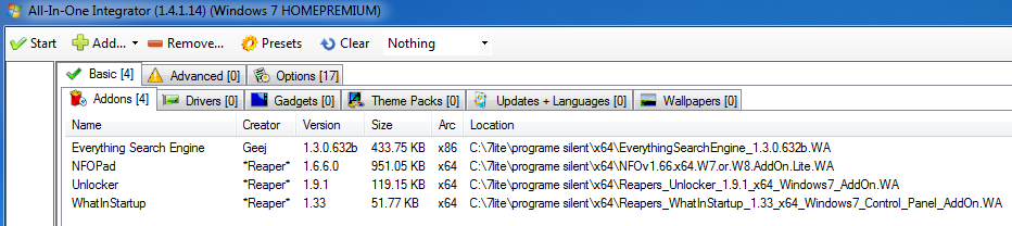

Tried your addon on both x86 and x64 VM. Soon I'll also install it on a real system (the resulted iso with your addon). I have only two small issues to report.
1. As you can see attached, although the addon also integrates in a x64 image, it's supposed to be shown as dual arch. It's shown as x86 - some may think it's only meant for x86.
2. The Search Everything (UAC) startmenu shortcut doesn't start on a x64 VM with UAC on. However, the normal shortcut without UAC in the title starts. So the whole purpose of having an UAC shortcut is gone, I think it's better you only show one shortcut that works both with UAC on and off - if that is possible, of course. :)

Hi, RicaNeaga. On the first issue, when I build the .WA through WTK addon maker, I select x86 (which means for both arch).
Maybe this is how it is display. I dun know. I can't just select !x86 or !x64 only right?
myselfidem have tested the UAC shortcut in x64 and reported okay. Hence I have no clue what is the issue now...
Any further insight would be nice...
