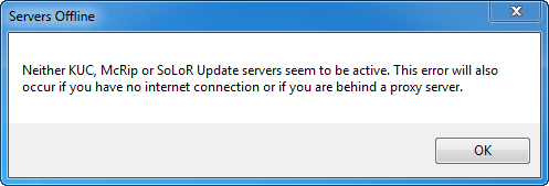

Thanks for the addition to the server white-list. But it seems I still cant connect with WTK 1.4.0.77. No problem connecting with the beta. I've turned off my local firewall, still no success. I don't think it's anything in my router, because I can still connect with the WTK Beta. I've also tried flushing the DNS resolver cache, still no success.
My ISP doesn't use a proxy server, At least none that I can see.
I was under the impression that my Routers WAN IP was dynamic, if it's static as you suggest, all the better. Any ideas? Perhaps trying on another PC, but i don't think so.
Edited by dotfusion
Ahhhh. Thanks for the heads-up.
It won't work with v1.4.0.77 because it doesn't send a header with it's http request and it ends up being rejected. The problem is with v1.4.0.77.

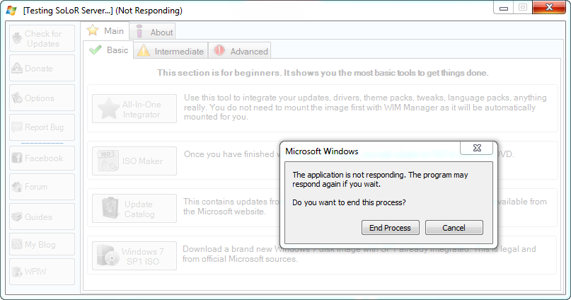

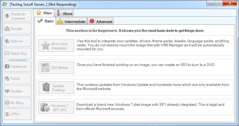

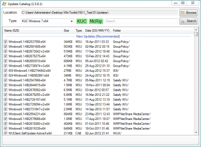

I'll try again tommorow after some sleep, but please take a look Lego in the meantime. Servers work ok when visited via the browser. I think it's an accesing bug with all the servers for Update Catalog in build test 20.
LE: More info - only happens on first use (after archive decompression). Then it's ok. Maybe it has something to do with scanning for updates? Weird...
post-25565-0-44611900-1351298535_thumb.p
Edited by RicaNeaga
Very weird - it works without issues in test 21 (when, btw, the scanning for updates gave me the 1.4.0.77 needed update), however in v22 it gives me even the attached error - happens at beginning when scanning for SoLoR servers.
So it's linked to either scanning for SoLoR servers, either because the scanning is stalling for another task in v22 (and it can't be for scanning for WinToolkit updates, as I've unticked that from the options - or maybe it doesn't work the unticking part, and the task is happening even so), either both, either smth else.

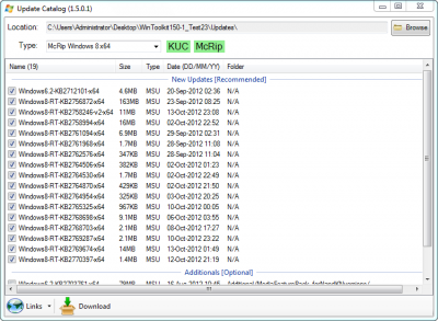

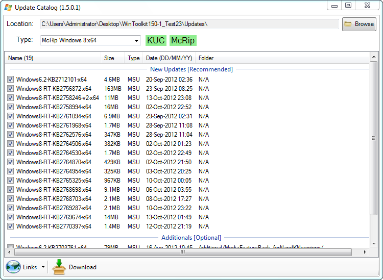

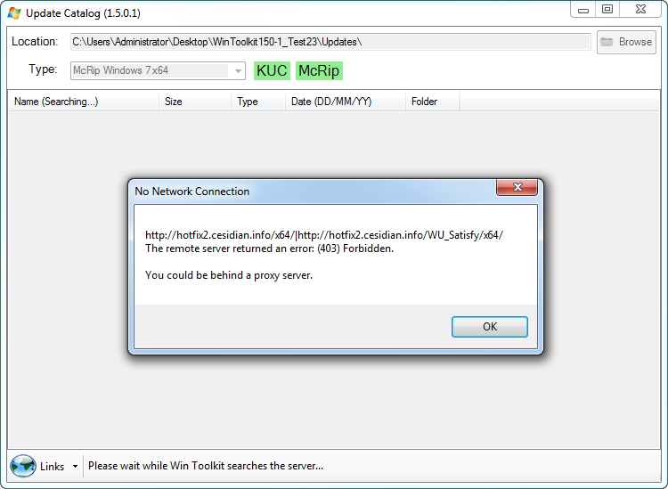

The problem above is gone in test 23, after you've removed SoLoR server (and probably other fixes), however oher two appeared after fulfilling my requests:
1) Selecting only msu and cab updates on the two servers is ok for windows 7 / 8, however it's not when it comes to office ones, that have the .msp extension. So please also add the .msp extenson to the ''allowed'' updates to be loaded. :)
2) Probably the new code change /filtering for McRip's server, made them inaccessible for me, but only for windows 7 ones, the windows 8 and windows office (with no updates, of course, sice almost all are .msp ones) ones load ok. The windows 7 ones give the 403 error (behind a proxy) - see attached.
