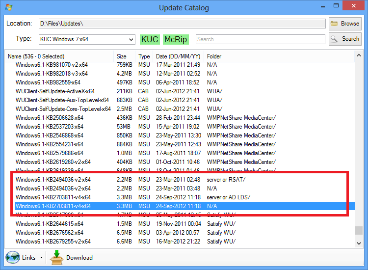

Small Problem A. With build 28 it hangs a little at loading McRip servers (right after pushing the Update Catalog button from Basic, 2-3 seconds, but after that everything is ok. :) Build 27 is lightning fast. :)
Problem B. Also,in v28, when downloading all the checked by default updates (Win Toolkit preset for KUC x64), it also downloads ''server or AD LDS'' folder with one update in it - Windows6.1-KB2703811-v4-x64 - and also ''server or RSAT'' with one update in it - Windows6.1-KB2494036-v2-x64.
This shouldn't happen, so please check again the preset code for all servers. Thanks :)
Problem C. Also, don't know why, but test 28 doesn't like two updates in komm's main folder - Windows6.1-KB2494036-v2-x64 and Windows6.1-KB2703811-v4-x64. It doesn't download them, and also directly deletes them if I run the tool again and point it to the same directory.
Question D. Wasn't Update Catalog supposed to move the superseded / extra updates in another folder? As you can see at problem C, it directly deletes them. Not really an issue, but maybe the old way with the Old folder is preferable in my opinion. :)

Problem A: Sorted.
Problem B: May need more details, what's suppose to happen.
Problem C: They download fine for me.
EDIT: They seem to disappear for me when i next load it also, I will investigate!
Problem D: It only deleted corrupt files (0 bytes in size). I haven't removed the old folder feature :/
Problem B: ''server or AD LDS'' and ''server or RSAT'' are in the Additionals (Optional) category. They shouldn't be downloaded, since they aren't selected in the preset, and also don't have nothing to do with the main (New Updates) Recommended'' category.
Problem D: I can guarantee that also updates are deleted, and not moved to an ''Old'' folder. Please investigate further. Thanks. :)
Lego, I can confirm this behavior here too. Test V28 on Windows 7 x64.

1. Start update catalog
2. Select KUC Windows 7 x64
3. All 'New Updates' (Recommended) by default :D are selected for download, nothing selected under 'Additional' (Optional)
3. Complete the Download Process
4. Browse to <download> folder and you will see that To folders for AD LDS and RSAT with updates inside that were not initially selected from step 3
Edited by dotfusion
preset - updates selected by Win Toolkit by default (pre-ticked - the main category / recommended). those two folders that aren't ticked / selected / not in the main category, but downloaded nevertheless, are the problem. I don't know how to explain it better. Sorry for my english. :D
So two updates, that aren't supposed to be downloaded, are downloaded ( ''server or AD LDS'' folder with one update in it - Windows6.1-KB2703811-v4-x64 - and also ''server or RSAT'' with one update in it - Windows6.1-KB2494036-v2-x64), and other two from the main (recommended) category aren't downloaded ( Windows6.1-KB2494036-v2-x64 and Windows6.1-KB2703811-v4-x64). maybe there's a link...
hahahahahahahahaha
with all those numbers I didn't verify to see if those were the same updates or not. I'll inform komm about this. problem solved - B and C from above. also very likely problem D, since those two updates were deleted as they were found somewhere else in the same folder. but automagically deleted doesn't sound the same as automagically mmoved to fiile OLD. :D
Sorry for not beeing more careful - don't know how I missed that. :D

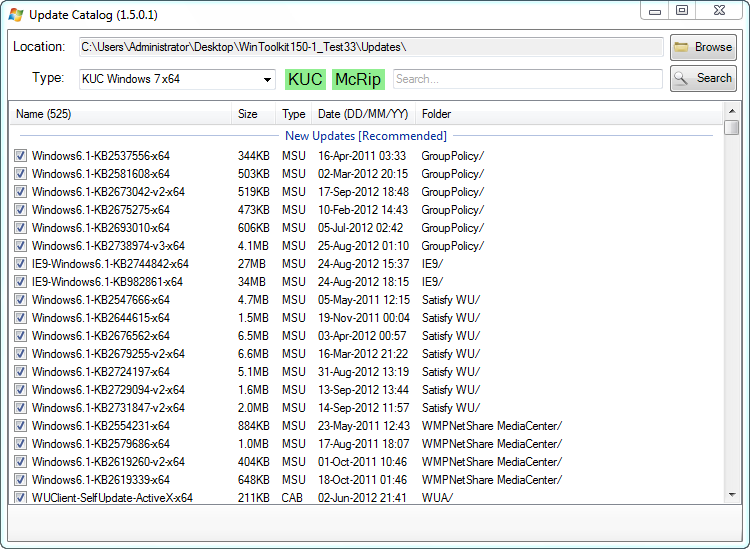

In the test 32 version all my problems from my previous post are still present - the five updates from Problem 1 and 2 are nowhere to be found, and also "User_Extra_Updates" is still renamed by Win Toolkit to ''Old".
In test 33 again "User_Extra_Updates" is renamed to ''Old", however now the Download button is just gone from the Update Catalog interface, so can't say for sure for the other two problems, but pretty sure they're again present. :(
LE: Attached a proof of this (missing download button in test 33).

:ranting: :censored: Visual Studio removed the buttons on the toolstrip, it randomly does this every so often and it does my head in. I've restored it and added the User_Extra_Files or whatever you put it as. I'm running behind as all of the current threads are being mixed around and confusing the hell out of me.
UPDATE: Release t34.
Great! In test 34, The "User_Extra_Updates" folder isn't renamed anymore, so Win Toolkit doesn't look inside it, so problem fixed, and also the download button is back where is supposed to.
