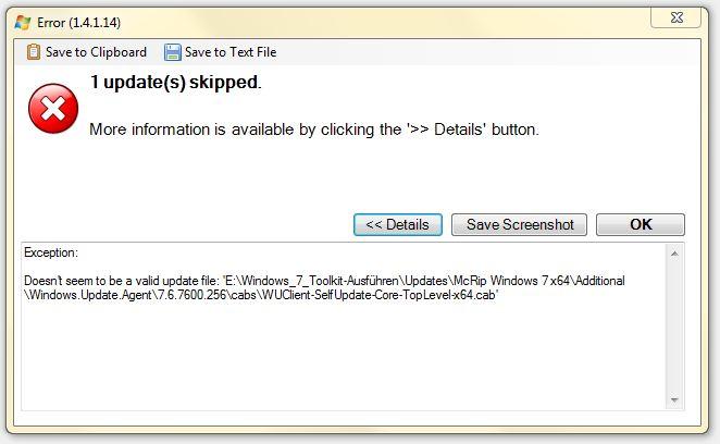

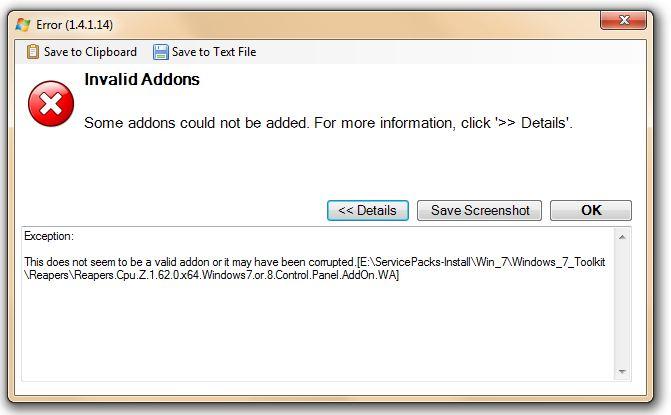

February 4, 201312 yr Something is running wrong..... test5 didn't work at all: no .cab recognisedintegration stays on IE9 a very long time (I stopped after 10 min)cancel integration didn't work (stopped with task-manager after 20 min) Test6works a bit more....: no .cab recognisedno add-on recognisedafter integration corrupted image and no chance to unmount. For both tests the same .ini and the same settings.txt;between test5 and test6 I corrected the mount-path under "Options" (Auto), otherwise WTK takes the path in the settings.*AIO#AddonsE:\ServicePacks-Install\Win_7\Windows_7_Toolkit\Reapers\Reapers_Arcade_Classic_Pack_5.10_x64_Windows7_AddOn.WAE:\ServicePacks-Install\Win_7\Windows_7_Toolkit\Reapers\Reapers_Microsoft_3D_Pinball_5.1.2600.5512_x64_Windows7_AddOn.WAE:\ServicePacks-Install\Win_7\Windows_7_Toolkit\Reapers\Reapers_Prime95_26.6.1.0_x64_Windows7_AddOn.WAE:\ServicePacks-Install\Win_7\Windows_7_Toolkit\Reapers\Reapers.Speccy.1.20.446.x64.Windows7.or.8.Control.Panel.AddOn - Thiersee.WAE:\ServicePacks-Install\Win_7\Windows_7_Toolkit\Reapers\Reapers.Cpu.Z.1.62.0.x64.Windows7.or.8.Control.Panel.AddOn.WAE:\ServicePacks-Install\Win_7\Windows_7_Toolkit\Reapers\Reapers.Win.Toolkit.1.4.1.14.x64.Windows7.or.8.AddOn.WA#ComponentsInbox GamesInternet GamesMobile PC Client Components (Basic)Mobile PC Client Components (Premium)Premium Inbox GamesTablet PC Components#DriversE:\DriverWin7\2333W-Inf\EV2333W.infE:\DriverWin7\Display_entpackt_12.6_legacy\W76A_INF\C7145534.infE:\DriverWin7\Display_entpackt_12.6_legacy\W76A_INF\CH145534.infE:\DriverWin7\Motherboard\Renesas_3.0_2.1.39.0\oem5.infE:\DriverWin7\Motherboard\Renesas_3.0_2.1.39.0\oem6.infE:\DriverWin7\Driver_Win7_7065_11212012\WIN7\64\rt64win7.infE:\DriverWin7\Motherboard\AHCI_win7\W764A\amd_sata.infE:\DriverWin7\Drivers Backup\Prolific USB-to-Serial Comm Port\oem30.inf#FilesBugle-call.wav::E:\ServicePacks-Install\Win_7\Extra-Win7\Icon-Sound\Bugle-call.wav;%SystemDrive%\Windows\Media\Bugle-call.wav;TrueElster.ico::E:\ServicePacks-Install\Win_7\Extra-Win7\Icon-Sound\Elster.ico;%SystemDrive%\Windows\Icons\Elster.ico;TrueKukuck.wav::E:\ServicePacks-Install\Win_7\Extra-Win7\Icon-Sound\Kukuck.wav;%SystemDrive%\Windows\Media\Kukuck.wav;TrueMagix.ico::E:\ServicePacks-Install\Win_7\Extra-Win7\Icon-Sound\Magix.ico;%SystemDrive%\Windows\Icons\Magix.ico;Truemfc100u.dll::E:\DriverWin7\mfc100u.dll;%SystemDrive%\Windows\System32\mfc100u.dll;Truemsvcp100.dll::E:\DriverWin7\msvcp100.dll;%SystemDrive%\Windows\System32\msvcp100.dll;Truemsvcr100.dll::E:\DriverWin7\msvcr100.dll;%SystemDrive%\Windows\System32\msvcr100.dll;Truenero.ico::E:\ServicePacks-Install\Win_7\Extra-Win7\Icon-Sound\nero.ico;%SystemDrive%\Windows\Icons\nero.ico;TrueOEMInformation.reg::E:\ServicePacks-Install\Win_7\$OEM$\$$\Setup\Scripts\OEMInformation.reg;%SystemDrive%\Windows\Setup\Scripts\OEMInformation.reg;TrueOEMLOGO.bmp::E:\ServicePacks-Install\Win_7\$OEM$\$$\System32\OEMLOGO.bmp;%SystemDrive%\Windows\System32\OEMLOGO.bmp;Trueoobe.cmd::E:\ServicePacks-Install\Win_7\$OEM$\$$\Setup\Scripts\oobe.cmd;%SystemDrive%\Windows\Setup\Scripts\oobe.cmd;TrueProfilbild.JPG::E:\ServicePacks-Install\Win_7\Extra-Win7\Icon-Sound\Profilbild.JPG;%SystemDrive%\Windows\Icons\Profilbild.JPG;TrueS65-Kukuck.wav::E:\ServicePacks-Install\Win_7\Extra-Win7\Icon-Sound\S65-Kukuck.wav;%SystemDrive%\Windows\Media\S65-Kukuck.wav;TrueToilet.wav::E:\ServicePacks-Install\Win_7\Extra-Win7\Icon-Sound\Toilet.wav;%SystemDrive%\Windows\Media\Toilet.wav;TrueW7_ptbtime_gesamt.reg::E:\ServicePacks-Install\Win_7\$OEM$\$$\Setup\Scripts\W7_ptbtime_gesamt.reg;%SystemDrive%\Windows\Setup\Scripts\W7_ptbtime_gesamt.reg;True#GadgetsE:\ServicePacks-Install\Win_7\Windows_Gadget\Austria.gadgetE:\ServicePacks-Install\Win_7\Windows_Gadget\Firefox.Clock.DE.GadgetE:\ServicePacks-Install\Win_7\Windows_Gadget\Italy.gadgetE:\ServicePacks-Install\Win_7\Windows_Gadget\shutdown_v2.gadgetE:\ServicePacks-Install\Win_7\Windows_Gadget\steuerung.gadgetE:\ServicePacks-Install\Win_7\Windows_Gadget\World_Clock.gadget#ServicesDisk Defragmenter::DisabledProgram Compatibility Assistant::DisabledSuperfetch::DisabledWindows Update::Disabled#Silent InstallsReapers.Java.Runtime.AIO.7.0.130.20.x64::;NO;41.25 MB;E:\ServicePacks-Install\Win_7\Windows_7_Toolkit\Reapers\Reapers.Java.Runtime.AIO.7.0.130.20.x64.exe;Always InstalledVisualC++AIO_x86::;NO;14.99 MB;E:\ServicePacks-Install\Win_7\Windows_7_Toolkit\Unantastbar\VisualC++AIO_x86.exe;Always InstalledVisualC++AIO_x64::;NO;17.47 MB;E:\ServicePacks-Install\Win_7\Windows_7_Toolkit\Unantastbar\VisualC++AIO_x64.exe;Always InstalledClassicShellSetup_3.6.5::;NO;6.03 MB;E:\ServicePacks-Install\Win_7\Windows_7_Toolkit\Thiersee\ClassicShellSetup_3.6.5_silent.exe;Always InstalledMSSecurityEssential_4.1.522.0_Win7_x64::/s /runwgacheck;NO;12.92 MB;E:\TeX-Virenscan\Virenscanner\MSSecurityEssential_4.1.522.0_Win7_x64_install.exe;Always InstalledMSSecurityEssential_Virendefinition_x64_mpam-fe::/q;NO;68.69 MB;E:\TeX-Virenscan\Virenscanner\MSSecurityEssential_Virendefinition_x64_mpam-fe.exe;Always Installed#Theme Packs|E:\ServicePacks-Install\Win_7\Windows_Theme\SienaArchitettura.themepackE:\ServicePacks-Install\Win_7\Windows_Theme\Antarctic.themepackE:\ServicePacks-Install\Win_7\Windows_Theme\Arctic.themepackE:\ServicePacks-Install\Win_7\Windows_Theme\austria1.themepackE:\ServicePacks-Install\Win_7\Windows_Theme\austria2.themepackE:\ServicePacks-Install\Win_7\Windows_Theme\BlueWater.themepackE:\ServicePacks-Install\Win_7\Windows_Theme\Brazil.themepackE:\ServicePacks-Install\Win_7\Windows_Theme\Canada.themepackE:\ServicePacks-Install\Win_7\Windows_Theme\CastlesOfEurope.themepackE:\ServicePacks-Install\Win_7\Windows_Theme\CatsAnytime.themepackE:\ServicePacks-Install\Win_7\Windows_Theme\CatsEverywhere.themepackE:\ServicePacks-Install\Win_7\Windows_Theme\DogsInSummer.themepackE:\ServicePacks-Install\Win_7\Windows_Theme\DuskDawn.themepackE:\ServicePacks-Install\Win_7\Windows_Theme\GalapagosByRG.themepackE:\ServicePacks-Install\Win_7\Windows_Theme\Italy.themepackE:\ServicePacks-Install\Win_7\Windows_Theme\JoshSommersBeaches.themepackE:\ServicePacks-Install\Win_7\Windows_Theme\SnowSports.themepackE:\ServicePacks-Install\Win_7\Windows_Theme\Surfing.themepackE:\ServicePacks-Install\Win_7\Windows_Theme\Surfing_1.themepackE:\ServicePacks-Install\Win_7\Windows_Theme\Tigers.themepackE:\ServicePacks-Install\Win_7\Windows_Theme\Winter.themepack#TweaksAdd 'Copy To Folder' to context-menuAdd 'Open CMD here' to Folder Context-menuAdd 'Open Elevated CMD here' to Folder context-menuLarger Taskbar PreviewsShow 'Computer' on DesktopShow 'Control Panel' on DesktopShow 'Network' on DesktopUnlock the taskbarAllow 3rd Party ThemesAlways Show Menu BarsChange Default Background::E:\ServicePacks-Install\Win_7\Windows_Wallpapers\architettura_siena-piazza-del-campo2.jpgRemove Shortcut SuffixShow All Icons on System TrayShow Drive Letters FirstShow Explorer StatusbarShow File ExtensionsShow Hidden Files & FoldersShow System FilesEnable DVD in Media PlayerShow Notepad StatusbarAlways Show Menu BarDisable Password Caching in Internet ExplorerIE Homepage::www.google.atLaunch Internet Explorer in Separate ProcessShow IE StatusbarUnlimited Simultaneous DownloadsChange Logon Background::E:\ServicePacks-Install\Win_7\Extra-Win7\Wallpapers\Kopie_von_100_0045_0001_NEW.jpgDisable User Account ControlRestore Previous Folder at LogonDisable Dr WatsonDisable HibernationDisable PrefetchDisable SuperfetchImprove USB Storage Devices Performance#UpdatesE:\ServicePacks-Install\Win_7\Windows_7_Toolkit\IE9-Windows6.1-LanguagePack-x64-deu.msuE:\ServicePacks-Install\Win_7\Windows_7_Toolkit\IE9-Windows7-x64-deu.exeE:\ServicePacks-Install\Win_7\Dr.Windows_Update_Pack\win7_updatepack_39_x64\patches\IE9-Windows6.1-KB2761465-x64.msuE:\ServicePacks-Install\Win_7\Dr.Windows_Update_Pack\win7_updatepack_39_x64\patches\Windows6.1-KB2621440-x64.msuE:\Windows_7_Toolkit-Ausführen\Updates\McRip Windows 7 x64\Additional\Windows.Update.Agent\7.6.7600.256\cabs\WUClient-SelfUpdate-ActiveX-x64.cabE:\Windows_7_Toolkit-Ausführen\Updates\McRip Windows 7 x64\Additional\Windows.Update.Agent\7.6.7600.256\cabs\WUClient-SelfUpdate-Aux-TopLevel-x64.cabE:\Windows_7_Toolkit-Ausführen\Updates\McRip Windows 7 x64\Additional\Windows.Update.Agent\7.6.7600.256\cabs\WUClient-SelfUpdate-Core-TopLevel-x64.cab#WallpapersE:\ServicePacks-Install\Win_7\Extra-Win7\Wallpapers\100_0001.jpgE:\ServicePacks-Install\Win_7\Extra-Win7\Wallpapers\100_0045_0001_NEW.jpgE:\ServicePacks-Install\Win_7\Extra-Win7\Wallpapers\100_0045_0001_NEW_16_10.jpgE:\ServicePacks-Install\Win_7\Extra-Win7\Wallpapers\100_0045_0001_NEW_16_9.jpgE:\ServicePacks-Install\Win_7\Extra-Win7\Wallpapers\AfternoonSun.jpgE:\ServicePacks-Install\Win_7\Extra-Win7\Wallpapers\alta-badia.jpgE:\ServicePacks-Install\Win_7\Extra-Win7\Wallpapers\AmwayTravelBeach_1280x1024b.jpgE:\ServicePacks-Install\Win_7\Extra-Win7\Wallpapers\AmwayTravelSun_1280x1024.jpgE:\ServicePacks-Install\Win_7\Windows_Wallpapers\Arch_Bridge.jpgE:\ServicePacks-Install\Win_7\Windows_Wallpapers\Arches_National_park.jpgE:\ServicePacks-Install\Win_7\Windows_Wallpapers\Bald_Eagle.jpgE:\ServicePacks-Install\Win_7\Windows_Wallpapers\Black_Cat.jpgE:\ServicePacks-Install\Win_7\Extra-Win7\Wallpapers\Bridge.jpgE:\ServicePacks-Install\Win_7\Windows_Wallpapers\Calico_Cat.jpgE:\ServicePacks-Install\Win_7\Extra-Win7\Wallpapers\CanyonWater.jpgE:\ServicePacks-Install\Win_7\Windows_Wallpapers\Cat_in_a_basket.jpgE:\ServicePacks-Install\Win_7\Windows_Wallpapers\Cheetahs.jpgE:\ServicePacks-Install\Win_7\Windows_Wallpapers\Cherry_Trees.jpgE:\ServicePacks-Install\Win_7\Windows_Wallpapers\Coral_Reef.jpgE:\ServicePacks-Install\Win_7\Extra-Win7\Wallpapers\DreamBay.jpgE:\ServicePacks-Install\Win_7\Extra-Win7\Wallpapers\Duomo_MI.jpgE:\ServicePacks-Install\Win_7\Windows_Wallpapers\Frog.jpgE:\ServicePacks-Install\Win_7\Extra-Win7\Wallpapers\Genitori.jpgE:\ServicePacks-Install\Win_7\Windows_Wallpapers\Green_Sea_Turtle.jpgE:\ServicePacks-Install\Win_7\Windows_Wallpapers\Hana_Highway.jpgE:\ServicePacks-Install\Win_7\Windows_Wallpapers\Hawaii-Welle.jpgE:\ServicePacks-Install\Win_7\Extra-Win7\Wallpapers\Haze.jpgE:\ServicePacks-Install\Win_7\Windows_Wallpapers\Kihei_Maui.jpgE:\ServicePacks-Install\Win_7\Windows_Wallpapers\Manarola.jpgE:\ServicePacks-Install\Win_7\Windows_Wallpapers\Moos.jpgE:\ServicePacks-Install\Win_7\Extra-Win7\Wallpapers\Mountains.jpgE:\ServicePacks-Install\Win_7\Extra-Win7\Wallpapers\Naldi.JPGE:\ServicePacks-Install\Win_7\Extra-Win7\Wallpapers\Naptime.jpgE:\ServicePacks-Install\Win_7\Windows_Wallpapers\nascosto_nell_erba.jpgE:\ServicePacks-Install\Win_7\Windows_Wallpapers\primo_piano_leone.jpgE:\ServicePacks-Install\Win_7\Windows_Wallpapers\Reflecting_Pond.jpgE:\ServicePacks-Install\Win_7\Windows_Wallpapers\Sailboot_at_Sunset.jpgE:\ServicePacks-Install\Win_7\Extra-Win7\Wallpapers\seaofconero.jpgE:\ServicePacks-Install\Win_7\Extra-Win7\Wallpapers\Silence.jpgE:\ServicePacks-Install\Win_7\Extra-Win7\Wallpapers\Snow.jpgE:\ServicePacks-Install\Win_7\Windows_Wallpapers\Swan.jpgE:\ServicePacks-Install\Win_7\Windows_Wallpapers\Tiger_Cub.jpgE:\ServicePacks-Install\Win_7\Extra-Win7\Wallpapers\Wolf.jpg#OptionsCompatibility CheckEnable BeepEnable CMDForce UnsignedLog Registry ChangesPrepare DriversPrompt AddonsPrompt DriversPrompt GadgetsPrompt SilentPrompt ThemesPrompt UpdatesPrompt WallpapersRebuild Image Test4 is working without problems. BTW: McRip's-Server is not working. Regards, Thiersee Edited February 4, 201312 yr by Thiersee
February 4, 201312 yr Author Thanks for reporting the bugs, I will spend a few more hours fixing crap and let you all know when a new test build comes out. Feel free to keep posting McRip server is out of my control.UPDATE 1:Already fixed addon and cab issues and probably other issues regarding extraction Mounting/Unmounting also seems fine now (used same code above).UPDATE 2:Test 7 has been uploaded.
February 4, 201312 yr Test 7: .cab issue is still present (same error) but IE9 Language Pack as .cab (extracted from .msu) works, as .msu comes this error AddOns are recognised again.
February 5, 201312 yr Hi Liam, sorry for reporting bad news again! Test 8:integrating IE9 Language-Pack as .msu gives an error, but the LP will be integrated Title: Extraction ErrorErrType: Error (1.4.1.14)Description: There was an error extracting files.Exception:Exception:Microsoft Windows [Version 6.1.7601]Copyright © 2009 Microsoft Corporation. Alle Rechte vorbehalten.E:\Windows_7_Toolkit-Ausfhren>Set SEE_MASK_NOZONECHECKS=1E:\Windows_7_Toolkit-Ausfhren>"D:\Temp\WinToolkit_Files\7z.exe" x "E:\ServicePacks-Install\Win_7\Windows_7_Toolkit\IE9-Windows6.1-LanguagePack-x64-deu.msu" -o"C:\WinToolkit_Temp\cInst" *.txt -aoa7-Zip [64] 9.30 alpha Copyright © 1999-2012 Igor Pavlov 2012-10-26Processing archive: E:\ServicePacks-Install\Win_7\Windows_7_Toolkit\IE9-Windows6.1-LanguagePack-x64-deu.msuNo files to processFiles: 0Size: 0Compressed: 745749E:\Windows_7_Toolkit-Ausfhren>exit the three cabs for WUClient (McRip) give errors and will be NOT integrated ActiveXitle: Extraction ErrorErrType: Error (1.4.1.14)Description: There was an error extracting files.Exception:Exception:Microsoft Windows [Version 6.1.7601]Copyright © 2009 Microsoft Corporation. Alle Rechte vorbehalten.E:\Windows_7_Toolkit-Ausfhren>Set SEE_MASK_NOZONECHECKS=1E:\Windows_7_Toolkit-Ausfhren>"D:\Temp\WinToolkit_Files\7z.exe" x "E:\Windows_7_Toolkit-Ausführen\Updates\McRip Windows 7 x64\Additional\Windows.Update.Agent\7.6.7600.256\cabs\WUClient-SelfUpdate-ActiveX-x64.cab" -o"C:\WinToolkit_Temp\cInst" update.mum -aoa7-Zip [64] 9.30 alpha Copyright © 1999-2012 Igor Pavlov 2012-10-26Error:cannot find archiveE:\Windows_7_Toolkit-Ausfhren>exit AuxTitle: Extraction ErrorErrType: Error (1.4.1.14)Description: There was an error extracting files.Exception:Exception:Microsoft Windows [Version 6.1.7601]Copyright © 2009 Microsoft Corporation. Alle Rechte vorbehalten.E:\Windows_7_Toolkit-Ausfhren>Set SEE_MASK_NOZONECHECKS=1E:\Windows_7_Toolkit-Ausfhren>"D:\Temp\WinToolkit_Files\7z.exe" x "E:\Windows_7_Toolkit-Ausführen\Updates\McRip Windows 7 x64\Additional\Windows.Update.Agent\7.6.7600.256\cabs\WUClient-SelfUpdate-Aux-TopLevel-x64.cab" -o"C:\WinToolkit_Temp\cInst" update.mum -aoa7-Zip [64] 9.30 alpha Copyright © 1999-2012 Igor Pavlov 2012-10-26Error:cannot find archiveE:\Windows_7_Toolkit-Ausfhren>exit CoreTitle: Extraction ErrorErrType: Error (1.4.1.14)Description: There was an error extracting files.Exception:Exception:Microsoft Windows [Version 6.1.7601]Copyright © 2009 Microsoft Corporation. Alle Rechte vorbehalten.E:\Windows_7_Toolkit-Ausfhren>Set SEE_MASK_NOZONECHECKS=1E:\Windows_7_Toolkit-Ausfhren>"D:\Temp\WinToolkit_Files\7z.exe" x "E:\Windows_7_Toolkit-Ausführen\Updates\McRip Windows 7 x64\Additional\Windows.Update.Agent\7.6.7600.256\cabs\WUClient-SelfUpdate-Core-TopLevel-x64.cab" -o"C:\WinToolkit_Temp\cInst" update.mum -aoa7-Zip [64] 9.30 alpha Copyright © 1999-2012 Igor Pavlov 2012-10-26Error:cannot find archiveE:\Windows_7_Toolkit-Ausfhren>exit Thiersee

February 5, 201312 yr Author You windows update cabs have German characters in them, WinToolkit should had detected that :/

February 5, 201312 yr On 2/5/2013 at 10:46 AM, Legolash2o said: You windows update cabs have German characters in them, WinToolkit should had detected that :/But it didn't!I think, the problem is 7zip in the 9.30-Version, as RicaNeaga said. The german characters are in the path: I changed "ü" in "ue" and the cabs have been recognized. The issue with the IE9-LP is still present, as I said in post #9: error but recognized. And again:Test4 (other extraction method) works. Thiersee
February 5, 201312 yr Author I've fixed both, Win Toolkit didn't check for foreign characters during adding to lists but did for integrating. I've now added the checking to the add method. Uploading now... EDIT: Test 9 uploaded.
