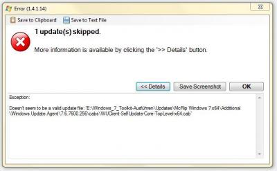

Well I said earlier I decided to I would try the latest versions so I wanted to take my previous integrated image that had only updates added and add 3 more that MS update showed but when I tried to add them it just keeps running and running and never completes... all I see is the image below:

EDIT: I tried to cancel it and that doesn't seem to work either it hasn't stopped after almost 15 minutes... I guess I will reboot

I noticed you have a "bang" (!) in the path: I would NOT use special characters in the path; I got problems with special (german) characters).

Hmmm that's something I have always done and it never caused any trouble before... I use ! and _ for my two main folders to keep them at the top...  and the integration with v4 worked without any trouble so has this changed between v4 and v15

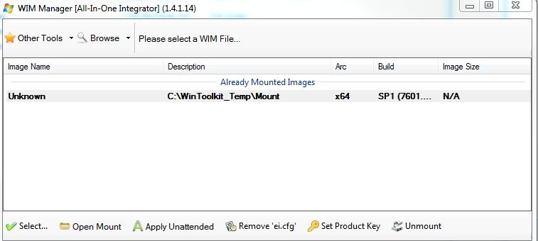

I was busy with other things today and din't realize that my forced cancel of last nights integration left a mounted image: C:\WinToolkit_Temp\Mount as an additional note I actually fell asleep before ending the "cancel' integration and it ran for almost 4 1/2 hrs before I forced it to end... now I will discard the mounted image with no save and see what happens
