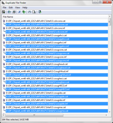

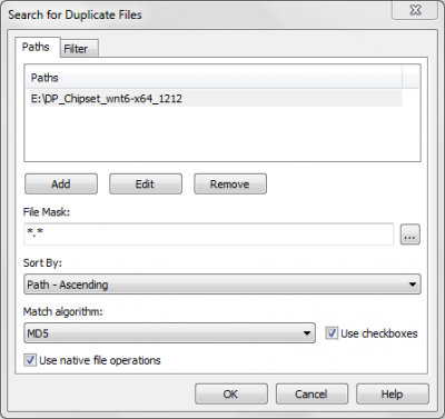

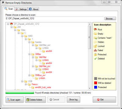

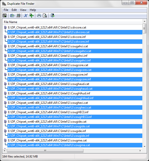

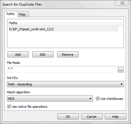

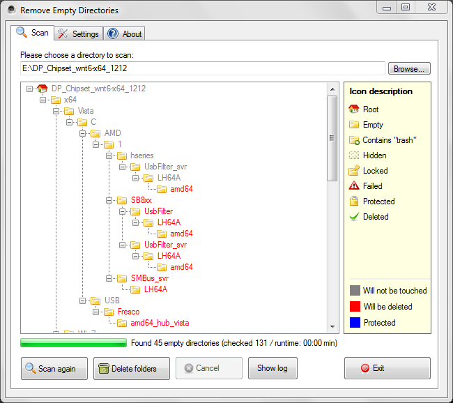

February 12, 201312 yr For the process of cleaning up my DriiverPacks I use two file utilities. Both of which are portable, lightweight and require no installation 1. Duplicate File Finder (to find and delete duplicate driver files)2. Remove Empty Directories (RED) (to delete any empty folders resulting from step 1) Example Scenario -- For this example I'll use 'DP_Chipset_wnt6-x64_1212' from DriverPacks. It's a good example because it contains quite a few duplicates. 164 duplicates are found in this pack to be exact. The first thing I do is unpack the driver package somewhere on my hard drive maintaining the original folder structure. The second thing I do is run 'Duplicate File Finder' to find duplicates on the folder where I unpacked the DriverPack. As you can see from the screen shots Duplicate File Finder found 164 files that have a duplicate (Size 14mb) all with the same MD5 Hash. The next step is to simply tell Duplicate File Finder to Select all duplicates and delete them. Optionally with the file utility you can choose to copy the dups or move them elsewhere. I choose to delete. Done! No more duplicates. [sCREEN SHOT REMOVED] -- I need the online space for other stuff. Sorry The last step is to run 'Remove Empty Directories' as shown is the screen shot below. As you can see 'RED' found 45 empty folders in the DriverPack. Now hit the Delete Folders Button and your done. As you can see WinToolkit shows no duplicates and anything left in the Win7 and vista folders are drivers that were not found in the ALL folder. This process shouldn't take an avid user no more than two minutes. [sCREEN SHOT REMOVED] -- I need the online space for other stuff. Sorry Update: I just want to bring something to your attention that I've only just realized before you try my method. Mr_Smartepants and mooms have pointed out to me that It may be wise to remove non-releavant OS folders first, prior to scanning for duplicates. You will also have to check for Incomplete folders as well. The reasons can be clearly seen in posts #20, #22, and #23. Edited February 17, 201312 yr by dotfusion

February 13, 201312 yr @DotFusion, it looks like when you did your scan you didn't remove the other OS folders before the scan. We duplicate some drivers between the OS folders in the packs intentionally.When I get some time (maybe) this weekend I'll try your method on each OS folder on its own (not the whole pack).

February 13, 201312 yr On 2/13/2013 at 6:48 AM, Mr_Smartepants said: @DotFusion, it looks like when you did your scan you didn't remove the other OS folders before the scan. We duplicate some drivers between the OS folders in the packs intentionally.When I get some time (maybe) this weekend I'll try your method on each OS folder on its own (not the whole pack). You make an excellent point. Any duplicates found in the other OS folders that are deleted will most likely break that folders specific driver in the sense that they will not install properly because of the now missing driver file. Further as mooms has pointed out that the same applies for other drivers found in 01, 02, 03, etc...Thanks Mr. Smartepants for pointing this out. Edited February 13, 201312 yr by dotfusion
February 13, 201312 yr I think it is dangerous to delete duplicate files, because sometimes they are (or seems at least) necessary.I have tested DFF in DP_LAN_wnt6-x64_1208 after deleting others OS folders (left Win7 and All): it found some duplicated files in some folders, but the others files in the same folders are not duplicates ! (they are indeed same files but belongs to another "sets" of drivers)So if we delete one each of the files, we are left with "incompletes" folders and I think the drivers can't be installed. I don't know if it's clear, rather see the image to understand what I'm saying:
February 13, 201312 yr Thanks for pointing this out. I'll be revising my method to remove non-relevant folders prior to scanning for duplicates with Duplicate File Finder. I think the left over incomplete folders could also be deleted because the one remaining would satisfy the now defunct incomplete. Edited February 13, 201312 yr by dotfusion
February 13, 201312 yr On 2/12/2013 at 11:49 PM, compstuff said: DotFusion... love the tools our logic and methodology was the same but yours seems really slick... I am trying it with my next set thanks I just want to bring something to your attention that I've only just realized before you try my method. Mr_Smartepants and mooms have pointed out to me that It may be wise to remove non-releavant OS folders first, prior to scanning for duplicates. You will also have to check for Incomplete folders as well. The reasons can be clearly seen in posts #20, #22, and #23. Edited February 13, 201312 yr by dotfusion
