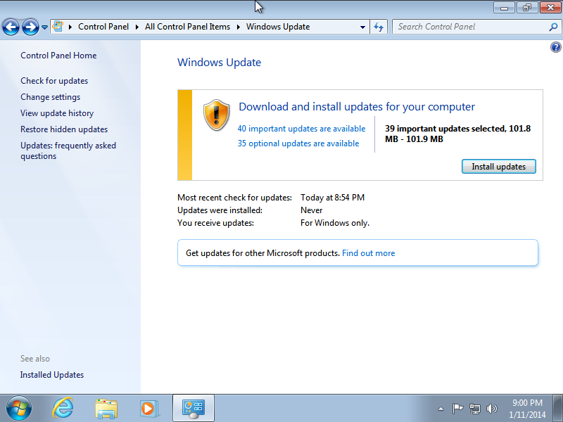

Posted January 12, 201411 yr Result of the test: IE11 is successfully integrated and in French, all silent installers are successfully installed, but:- Windows Update founds 41 updates (not counting Windows Defender Update).All of them have been reported successfully integrated by Win Toolkit.see image:Logs are here: WinToolkit141-29Test_16.zip

January 12, 201411 yr Author Go to View Installed Updates and see what's in there.It shows 109 updates installed. (should be 145)135 updates are integrated and the rest is installed at RunOnce so it seems consistent with Windows Update. Are you sure you didn't integrate them into Home Premium or whatever and then installed Ultimate by mistake?Yes I'm sure. In this case it should be way more than 41 updates found on WU anyway. Did you see it save the image successfully?Not sure about this particular sentence, but I didn't see any error message and all updates were reported as integrated in the Update+Language tab. (all were in green, then showed install pending once finished)Will test again with test17 and report here.
January 12, 201411 yr Author Result of the test with test17:All updates showed as integrated:1 2 Once on the desktop, only 109 updates installed. It should be 145I used the exact same configuration than test16 (copied ini and settings). edit: didn't see your post dareckibmw, so the bug is confirmed.In a sense, I'm glad I'm not the only one, that means the bug is not on my end.
