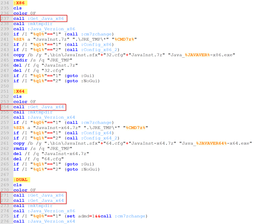

I think I found what caused the error: in every line
ECHO SetEnvironment="DelOldVer=%%%%P:hidcon:cmd /c For /F \"tokens=2 delims={}\" %%a In ('Reg Query %%swUninst_%%%%P%% ^| FINDSTR \"%GUID%\"') Do exeExec /x{%%a}">> "32.cfg"
you wrote exeExec, but this command does not exist: I changed it in MSIexec and it works.
Installed 8u72, updated to 8u74: every time the previous (or already installed) version has been uninstalled.
An already installed 8u74 has been uninstalled too.

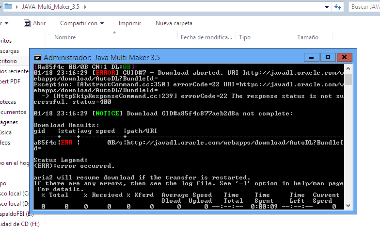

Hi mooms,
the JavaMaker (3.4) does not work again: it does not download the install files; if I put the manually downloaded files in the folder, the AIO is being generated.
Thiersee..Im not even able to download Java from the official site..seems that there is some problem in java "field" I guess,cos I don't have any explanation?Did some one else got the same problem?
Sorry, but the code used to find the download URL was made by Strych9, and I don't know how to use curl. If someone is able to update it, it will be cool.
I have sent a PM to Strych9, let see if he responds.
In the meantime, you can download the file(s) with this URL (more convenient by the one given by Thiersee)
https://java.com/en/download/manual.jsp
then put the offline installer(s) in the same folder than the script, it will make installers as usual.
