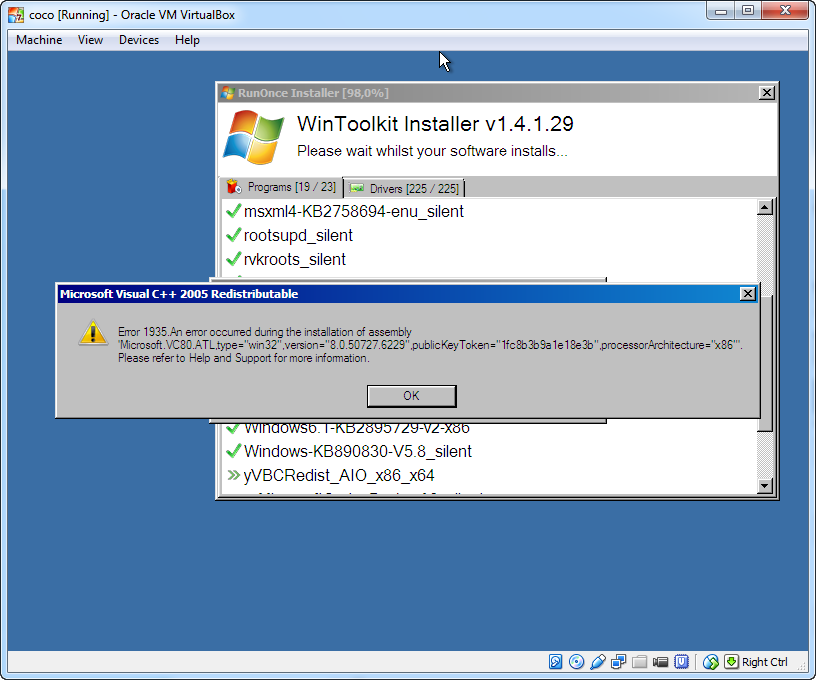

Posted January 18, 201411 yr Made my usual x86 build, with either beta 1.4.30.3 or 1.4.29 stable (I had them both on the desktop, can't remember, sorry). But I'm sure these are replicable on either of them, even the latest 1.4.30.5. See attached, now with the newest RunOnce I also have problems in a x86 build with ricktendo's VBC AIO installer (usual /y switch), and now also with Kel's Runtimes installer (never had such problems before) - no switch, silent by default. Please test them both yourself, Lego, and most importantly on x64 (I'm very very sure VBC AIO will give at least 4 errors, as usual). And this errors have nothing to do with the installers, they install just fine on a live system.

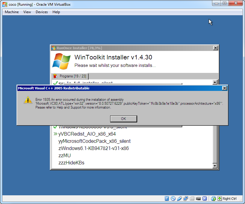

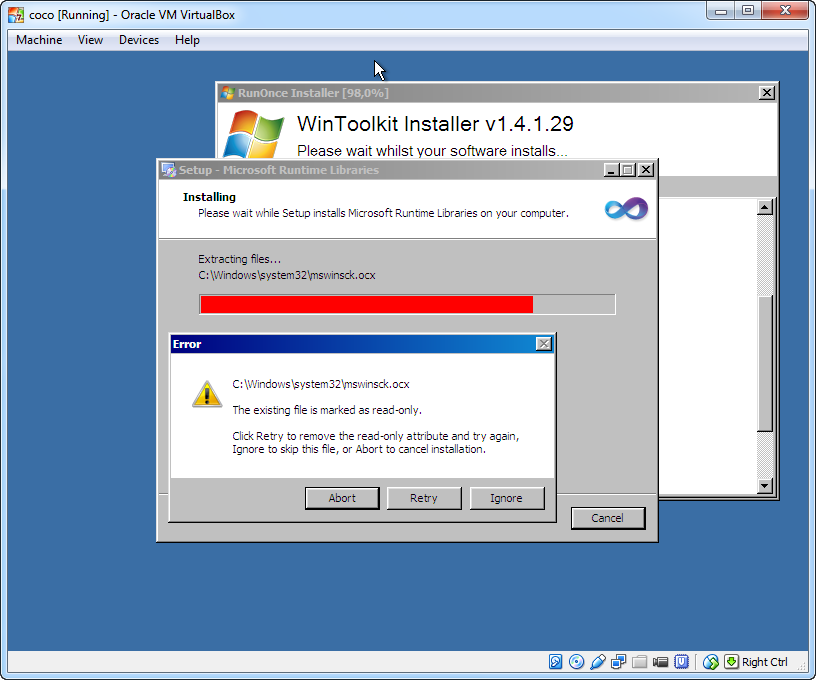

January 19, 201411 yr Author The first one with kel's runtimes is still present in a x64 build, via latest 1.4.30 beta 9. See attached. So it's safe to say it can be present in both x86 and x64 builds. ''Curiously'', although I expected it, ricktendo's VBC AIO was ok on x64. So maybe you changed something regarding the 7z SFX, as in older build it was the othe way around, it was ok in x86 and wasn't in x64 builds. Now it's ok in x64 and it isn't in x86. So please, alongside kel's runtimes, please also try in the same build also ricktendo's VBC+ installer (the smaller one, with the usual /y switch), but most importantly try it on a x86 build!!!
January 20, 201411 yr Author all reported bugs are still present in a x86 image made with 1.4.30 beta 11. see attached So please, alongside kel's runtimes, please also try in the same build also ricktendo's VBC+ installer (the smaller one, with the usual /y switch), but most importantly try it on a x86 build!!!
January 22, 201411 yr Author Have you got time to look at these nasty bugs, Lego? Again, to replicate them... Quote alongside kel's runtimes, please also try in the same build also ricktendo's VBC+ installer (the smaller one, with the usual /y switch), but most importantly try it on a x86 build!!!

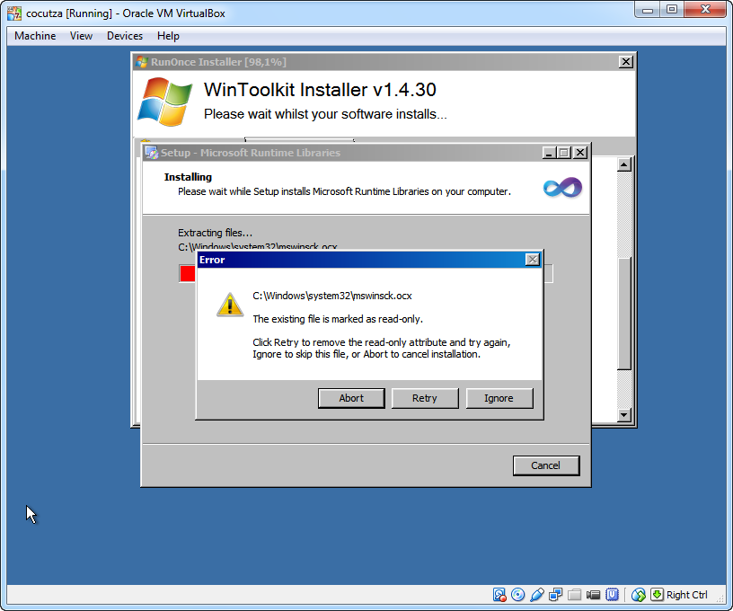

January 23, 201411 yr Author Can confirm that the read-only bug was fixed in beta 3. However the other two weren't, as you can see attached. Going to post soon all the info presets logs etc in another post. Offtopic: btw, 150kb maximum upload size for ALL attachements to a post. Really? I'm forced to make another post to add something else...

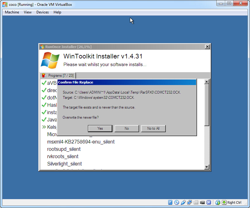

January 24, 201411 yr Author You were right!!! I tried a build with ricktendo's installer first in the silent installer list. Making this installer the first one in the silent installer queue makes the errors go away (I think everything is also ok afterwards, as VC2005 and 2008 appear installed in control panel after the install process is complete). So the errors appear only during the presence of Win Toolkit's Runonce interface. So please find out why. Also now I get another errors, many, not caused by Win Toolkit, but because some files from kel's installer are older than the ones in ricktendo's. Maybe a fix for these (see attached - posted only one, I had many similar pop-up) won't hurt, smth like a rule, when an older file tries to overwrite a newer file to always keep the newer one Edited January 24, 201411 yr by RicaNeaga
January 24, 201411 yr Explains why I don't get the error. On 1/24/2014 at 4:48 PM, RicaNeaga said: Maybe a fix for these (see attached - posted only one, I had many similar pop-up) won't hurt, smth like a rule, when an older file tries to overwrite a newer file to always keep the newer one That's out of my control. The best thing to do is to notify Kels and Rick about the situation. Me best bet about the previous errors is that something which installed before them needed to the computer to restart.
