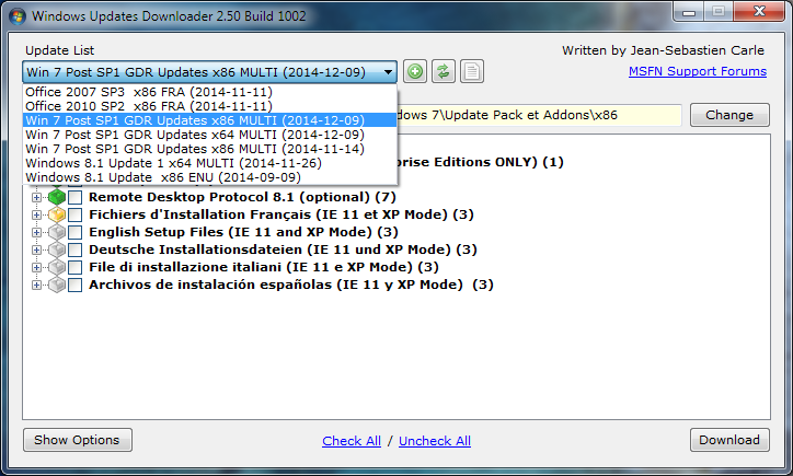

Hi rhahgleuhargh,
First point:
I have a very strange issue with WUD and the ULs 30-11-2014 and 09-12-2014 for both architecture:
I can NOT load the four lists at the same time,  the one overwrites the other!
I explain exactly (I hope):
I load for example both list for the 30-11-2014 and they appear in WUD;
after that I load both lists for the 09-12-2014 and they appear in WUD, but the the others from 30-11-2014 DISAPPEAR!
If I load "crosswise", i.e. x64 from 30-11-2014 and x86 from 09-12-2014 no problem; with older list (11-11-2014 and 18-11-2014) no isssues!
I unpacked all four lists and opened with Notepad++ to compare the contents I read at min 10 times the lists, but I did not find any error.

@Thiersee,
Since the name of the ULs is the same (except for the date), it seems to be normal that the new one erases the older one. If you want to keep the old list, you have to rename it (ex. TEST-.ul), and place it in the WUD directory (extract .ulz file, don't double-clic on it). Have a look on my screen capture below.
For this month I only added the new urls and deleted the 2 supesesed KBs (IE 11 and Update section, have a look on my previous post for changelog).
For KB3006625 :
I always compare for my tests the results of KBs asked by WU in my real machines (7 ultimate x64 installed in march 2013 starting from mooms update pack, 7 x86 pro installed in march 2014 with my UL, and 7 x86 HP installed in may 2014 using UL) and in my VM created (7 pro x86 and x64) with the UL from the previous month. This KB was asked by WU in all machines. But it's normal because all my work is based on moom's one for a minimalist update list !
What are your "not integrable KBs" ? maybe the answer is here... if some additional KBs are installed KB3006625 could be useless. But if these additional KBs are not in the list, it's because they weren't asked by WU after a fresh installation.
post-40091-0-30055900-1418323592_thumb.p
Edited by rhahgleuhargh
Exactly this caused my mistake ;)...
