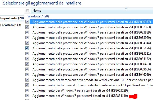

Hi,
another issue I have:
because of the problems with some update from last patch-day I integrate now using rhahgleuhargh's UL from february 24-02-2015, adding the working updates and KB3000483.
Testing with only updates from the list (with RDP 8.1 and IE11), for x86 updates from patch-day march are requested by WU, of course ;).
For x64 WU is asking not only for updates from patch-day march, it request KB2834140 (IE prerequisite, 811KB) too, even if this KB is in the UL and is shown as installed in the list of installed updates and I don't find the reason why!
It's not depending from OS-language.
Did anyone experience the same issue?
TNX, Thiersee

KB2834140 is a bi-update, it can be installed (offered) with/without platform update KB2670838
so if you installed it before KB2670838, you have to install it afterwards too

You are the best and my SAR-man (Save And Rescue) ;)!
I made a mistake in the WTK-Integration for x64: I didn't put KB2670838 before KB2834140, but I was not able to see it without your hint; x86 was OK from the beginning.
Thanks a lot.

Problem is already solved with the hint from abbodi1406, see posts #486 & #487.
On x64 was the sequence in WTK not correct, KB2670838 must be installed before KB2834140.
