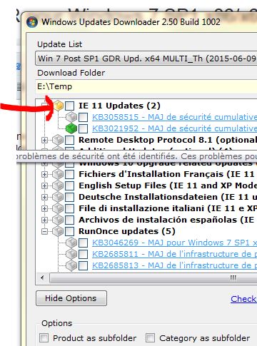

According to aboddi1406 list @MDL KB3021952 (IE11 Updates) superseded/no longer needed:
http://forums.mydigitallife.info/threads/19461-Windows-7-Hotfix-repository/page1001?p=1041567&viewfull=1#post1041567
Removed/Superseded:
Code:
3021952 (by 3058515) / IE11
He is usually right... will test in VM & report. :)

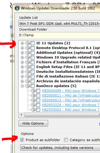

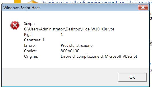

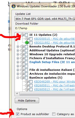

Hi rhahgleuhargh,
1) the .vbs-script downloaded from dropbox give an errorr, the "old" one from post #1 NOT.
2) In the Readme.TXT (post #1) (setting for WUD) "Product as sub-folder" should be unchecked, otherwise WUD does not show (colour), if it contains someting or not.

I'll check the script, there was probably a bug when I renamed it.
For the Readme file, I'll add "uncheck product as folder". Correction tomorrow, I'm not home today.
Removed/Superseded:
Code:
Confirmed!
Tested on VM x86 (HP) & x64 (Prof): no request for KB3021952!
