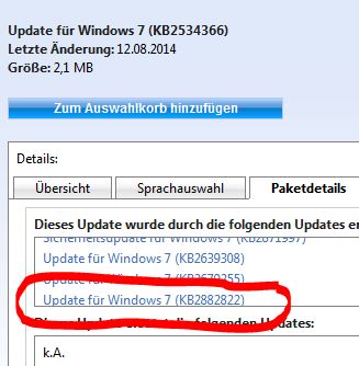

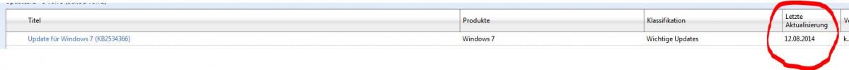

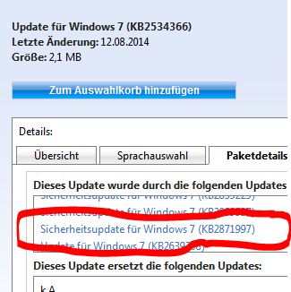

On some internet sites I read this SP1-fix is related to KB2534366, but:
1) just this one has been replaced by KB2882822 and KB2871997
2) The last change for KB2534366 was 12.08.2014!
I tried an integration with 2534366, KB976932 has been requested by WU, I installed after that KB2871997 & KB2882822, same request by WU!
I don't really understand, what MS is doing :guns: !
