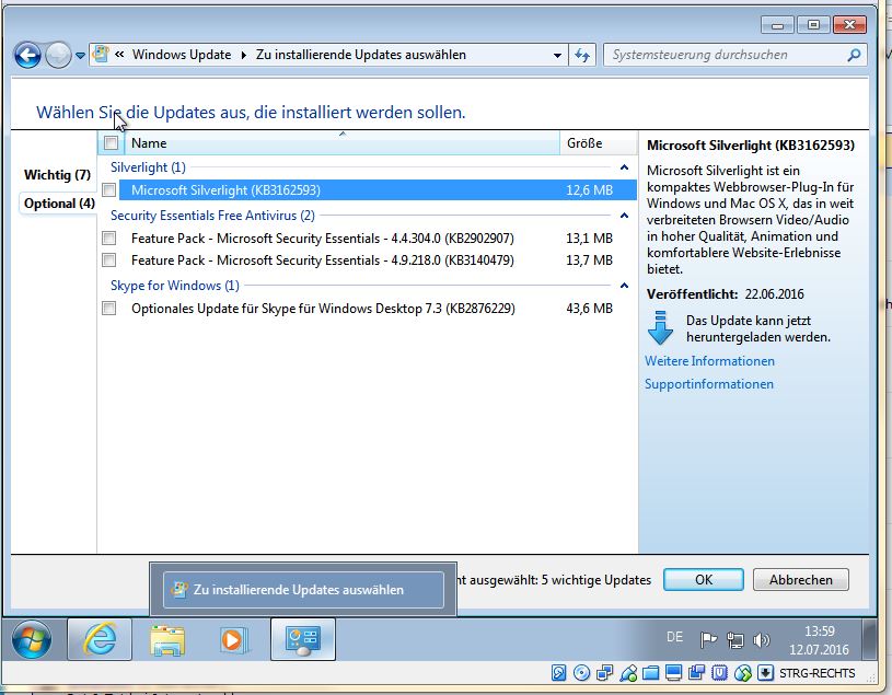

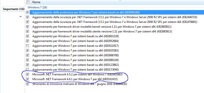

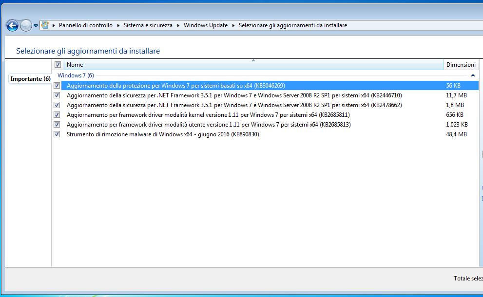

Hi Ron,
here the result
Picture 1: after installing in the way I described
Picture 2: after manually installing @ricktendo's NFW-repack
Don't care about the two KBs for NFW3.5.1, it' MS :rolleyes:; they will be hidden by @rhahgleuhargh's script rollup.exe, together with all the W10-related KBs.
All other KBs will be installed later by WPI.
BTW, vacation is always fortunately :D
Edited by Thiersee

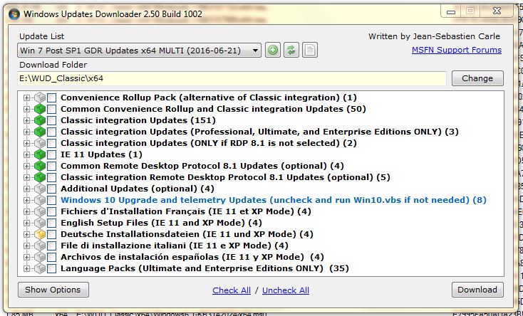

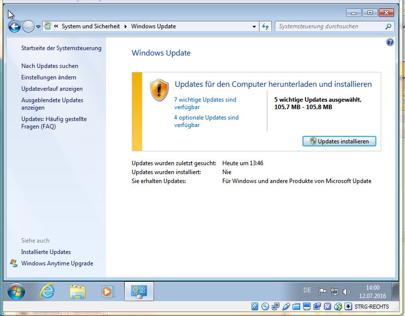

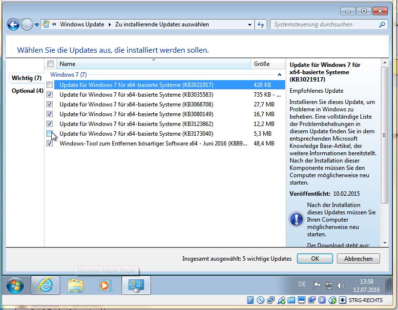

@pennsylvaniaron
Did you really made an installation with only updates + IE11 as you said in your post from July 2 during your vacation or not?
Quote
So I'll make it really vanilla clean when I get home
I can only repeat it: make the integration step by step!
Regards, Thiersee
Edit:
I just finished an integration (classic mode): no trace of KB3136000-request
What I did (Win7-Professional, German, x64):
1) I integrate with WTK all the Common/Classic updates + RDP 8.1 + IE11, nothing others! (Picture 1)
2) In a second step I integrated the .WA-addon for NFW 4.6.1; the result see you in the pictures 2, 3, 4.
BTW, it passes sfc /scannow
Edited by Thiersee
