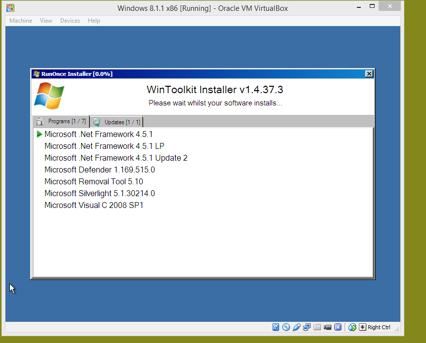

Hi Lego,
from V 1.4.34.12 - 1.4.37.3 i can integrate Programms to Silent Installer, but when Windows Start at the setup,
It does not lead to the RunceInstaller.
See the Screen, i can integrate but the installation is fault :-(
the last V it is works is 1.4.35.5!!!
P.S. all programms do you see on screenshot works corectly with silent installer / Runce installer
at V.1.3.35.5
but not from V 1.4.34.12 - 1.4.37.3 :-(
the runceinstaller not appear!

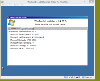

Hi Lego, sorry, with 1.4.37.4 Does it not also!
Hi Lego,
from V 1.4.34.12 - 1.4.37.4 i can integrate Programms to Silent Installer, but when Windows Start at the setup,
at V.1.3.35.5
but not from V 1.4.34.12 - 1.4.37.4 :-(

Worked fine for me. Are you installing it from USB or DVD?
post-10183-0-81546300-1395569353_thumb.p
EDIT: Hmm, i think it only the first one installed. The rest displayed an error and made RunOnce close itself.
EDIT: I believe the first one try to make the entire thing restart. You need to add /norestart after the .NET 4 ones i think.
37.5 dont work (DVD) :-(
By my The window runonce installer it Not here :-(
you mean so?
XXXX.exe /q /norestart
Edited by bphlpt
Merged posts
Oh, ok its go! ;-)
Jipiii
/q /norestart go !!! ;-) JUHUUUUUUUUUUUUU
