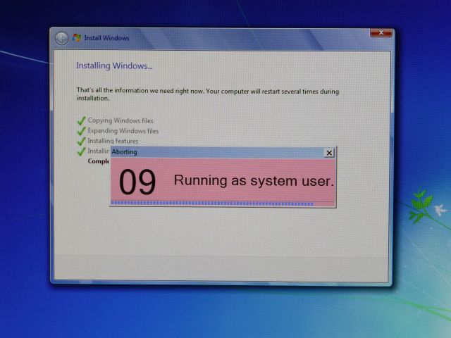

Posted April 12, 201410 yr Please tell me what that was.... At the end of the installprocess a big, pink poppup which said something like "Running as system owner" popped up... What was that?
April 13, 201410 yr Welp, my Google found nothing so if you want help, you may need to provide more info and/or screenshot. It's ok, you can take it with your phone, as long as the error message and that pink thing are visible.
April 14, 201410 yr My crystal ball broke, so without any screen shots or any idea of the basics (What OS, What SP, What you did to it, what the source was) this is the only answer I can give: It was the added NSA spyware configuring itself...
April 14, 201410 yr Author Hi guys. I run win7 Ultimate, x64, SP1, fully uppdated with WTK (updates dl direct from MS), checked by WU. I saw "the pink box counting down from 10 to 1 and 0" again when I reinstalled a updated win7 including the april updates. It seems to be part of a process that takes ownership of the system for installing reasons. This was a 100% clean source ONLY modified with WTK, on a clean system with firewall an antivirus. So if this is something bad - I didn´t add it. BUT I think and I hope this is a part of the WTK install process. Thanx i advance! Edited April 14, 201410 yr by sweden8

April 14, 201410 yr I think its because Liam changed back to RunOnce. I'm looking for a thread and give you feedback in a few moments. Ok, look here post #48 : http://www.wincert.net/forum/topic/12111-solved-1437x-silent-installer-runonce-does-not-work/page-3 Here i saw what i think the whole time about RunOnce : Its not reliable ! http://support.microsoft.com/kb/314866/EN-US "Furthermore, applications should use the RunOnce keys only for transient conditions (such as to complete application setup); an application must not continually re-create entries under RunOnce.Doing so will interfere with Windows Setup." In my opinion RunOnceEx is the only way. Since Liam changed back to RunOnce I delete this registry key with WIM Registry Editor : [HKEY_LOCAL_MACHINE\WIM_Software\Microsoft\Windows\CurrentVersion\RunOnce]"!1WinToolkit"="WinToolkitRunOnce.exe" and then i let Setupcomplete.cmd write this registry-key : HKLM\SOFTWARE\Microsoft\Windows\CurrentVersion\RunOnceEx\050 /V 1 /D "%WINDIR%\System32\WinToolkitRunOnce.exe" /f ABSOLUTELY NO PROBLEMS with this solution and NO pink popup !! @LiamPlease change to RunOnceEx and most of the problems will be past Edited April 14, 201410 yr by Snow

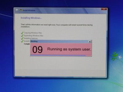

April 14, 201410 yr Author Would like to hear Liams comment. Installed it in Virtualbox and took a snapshot - not so great quality... Edited April 14, 201410 yr by sweden8
April 14, 201410 yr Oh it means it has detected it has ran at the wrong time. So it will re-attempt at the correct time (just before logon).
April 15, 201410 yr Author OK - thanx - that explained alot. Only time I saw it was just before logon - and the rununce installs didn´t work at all. Good luck with the schoolwork :thumbsup:
