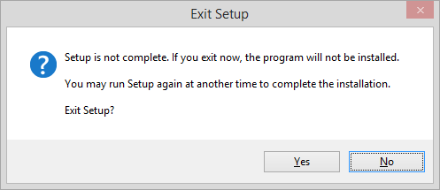

Open an installer, & press the cancel button. If the cancel windows looks like this:
post-69983-0-74330600-1423570114_thumb.p
then the installer is built using inno. And the silent install switch for installers made using inno is this: /VERYSILENT /NORESTART /SUPPRESSMSGBOXES /SP-  (for eg. uniextract & 7zip(32bit) installer)
