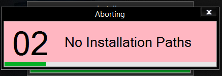

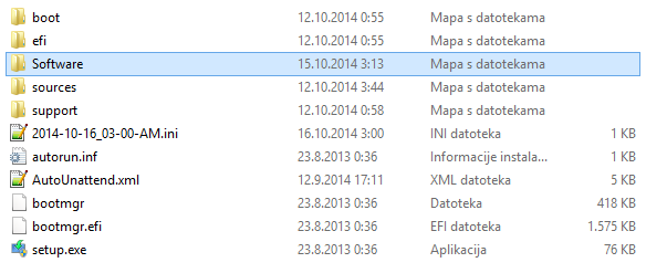

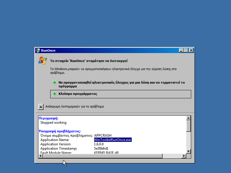

Posted October 17, 201411 yr Hi I have a problem with WinToolkitRunOnce.exe and that just will not start.I do not want on my DVD folder 'WinToolkit_Apps', I want the folder 'Software' or similar.WinToolkitRunOnce.exe start only if the folder 'WinToolkit_Apps'If on the %DVD% not available Wintoolkit_Apps folder then nothing is found I tried to edit the registry but without success, RunOnce will not start[HKEY_LOCAL_MACHINE\SOFTWARE\WinToolkit]"00000|ChromeSetupX64"="%DVD%:\Software\ChromeSetupX64\ChromeSetupX64.exe*"I also tried to set the file 'install.ini' but does not work, just will not run runonce#Any line starting with a # are comments and will be ignored.#Lets you specify the configuration of the installers#InstallDir is where your apps are located.#DriverDir is which directories to scan for inf files.#Reboot makes RunOnce reboot Windows after completion.#NOTE: INSTALLDIR will ALWAYS check the following directories even if not specified in the config section:#INSTALLDIR=Sources\WinToolkit_Apps#INSTALLDIR=WinToolkit_Apps[Config]INSTALLDIR=%DVD%:\SoftwareDRIVERDIR=Sources\Drivers#Here are some other samples.#INSTALLDIR=E:\Software#DRIVERDIR=X:\MyDriverCollectionREBOOT=FALSE#Things which will always get installed. Anything after * is a switch i.e. /S /Q /Silent[Automatic]#KBXXXXXX-x64=%DVD%:\WinToolkit_Apps\Windows6.1-KBXXXXXX-x64\Windows6.1-KBXXXXXX-x64.msu#User will be asked to choose which of the following apps to install.[Manual]Google Chromex64=%DVD%:\Software\ChromeSetupX64\ChromeSetupX64.exe*#Microsoft Office 2013=%DVD%:\WinToolkit_Apps\Office2013\Setup.exe*/configure %DVD%:\WinToolkit_Apps\Office2013\config.xml#Example 1=%DVD%:\WinToolkit_Apps\ExampleProgram\Example.exe*/sDVD one my WinToolkit_RunOnce_Log.logVersion: 1.5.2.918.10.2014 3:58:31 Description:-----------------STARTING--------------18.10.2014 3:58:31 Description: IsSystem: FalseIsAdministrator: TrueUser: JIGSAW\dfd18.10.2014 3:58:31 Description: Creating Shutdown Handle.18.10.2014 3:58:31 Description: Loading...18.10.2014 3:58:31 Description: Detecting Drives18.10.2014 3:58:31 Description:DRIVE SCAN------------------------------Drive: C:\, Media Type: Fixed, Size: 33283895296, Free: 19588681728, Name: , Initial: TrueDrive: D:\, Media Type: Fixed, Size: 20847783936, Free: 6113918976, Name: , Initial: TrueDrive: E:\, Media Type: Fixed, Size: 21731733504, Free: 21298372608, Name: Nova jedinica, Initial: True------------------------------18.10.2014 3:58:31 Description: Detecting Paths18.10.2014 3:58:31 Description: Detecting Sources18.10.2014 3:58:32 Description: INI Found: D:\sources\install.ini18.10.2014 3:58:32 Description: Install Location Found: Setup D:\Software18.10.2014 3:58:32 Description: ERROR INI P1: Google ChromexSP2: %DVD%:\Software\ChromeSetupX64\ChromeSetupX64.exeP3:18.10.2014 3:58:32 Description: Detecting Drivers18.10.2014 3:58:32 Description: x64: True18.10.2014 3:58:32 Description: Removing Duplicates.18.10.2014 3:58:32 Description: No Installations.18.10.2014 3:58:42 Description: Starting18.10.2014 3:58:42 Description: Manual: 0 | Driver: 0 | Auto: 018.10.2014 3:58:42 Description: InstallPaths: 118.10.2014 3:58:42 Description: Deleting dpinst.exe18.10.2014 3:58:42 Description: Removing Shutdown Handle.And to mention WinToolkit RunOnce.exe will not delete itself. Heelp!Thanks! Edited October 18, 201411 yr by jigsaw5063
October 20, 201411 yr Author I am partially solved the problem so I am 'WinToolkit_Apps' folder marked as hidden.but problem is WinToolkitRunOnce.exe will not delete after finished installing softwarehow can I fix it ? Edited October 20, 201411 yr by jigsaw5063
