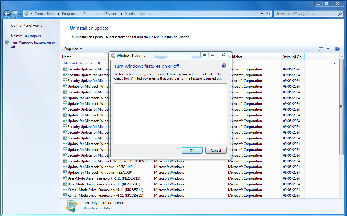

May 10, 2024May 10 Author Hi K4sum1, KB2533552 is a very old Servicing Stack (2011), which has been replaced by KB4490628 for ordinary updates and by KB5034865 for ESU updates. My KB2533552, unfortunately, causes Windows Features corruption. I recommend you hide KB976932, which is actually KB2533552. If you want to integrate it anyway, I recommend using UpdatePack7R2.
May 11, 2024May 11 I did my own manual edit type thing and it seems to work. Having that update there bothers me. Although what exactly do you mean by Windows Features corruption?
May 11, 2024May 11 Author Well! Can you attach your update.mum ? Have you integrated KB2533552 before KB4490628 ?
May 11, 2024May 11 Have the entire update and integrate script I made https://files.catbox.moe/9wglwu.7z Yes, it's the very first update I integrate in my list.
