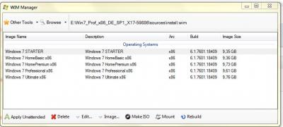

March 22, 201511 yr On 22.3.2015 at 0:43 PM, bphlpt said: ..... In the meantime, if you are able to work out the manual process successfully, then give back to the community by sharing the details of the process so others can do it too. Good luck! ..... I just tried it for Win7 x86 (is faster ) and it works! The sequence: 1) In the normal AIO choose the lowest version (for me STARTER) and Integrate all updates you need in that version. delete ALL other (HomeBasic, HomePremium, Professional, Ultimate) 2) Reload the .WIM and delete ALL other versions (HomeBasic, HomePremium, Professional, Ultimate) 2a) Rebuild the loaded .WIM. 3) When finished close WTK, go into the folder where your .WIM is located 4) Copy and paste the install.wim 4 times (three times for x64) 5) Open WTK, go to the "Intermediate-Tab" and start WIM-Manager 6) Load the 1st copy of the install.wim and upgrade it to HomeBasic 6a) Save the changes 7) Repeat step 6) and 6a) for the 2nd, 3rd and 4th copy of the install.wim and upgrade them respectively to HomePremium, Professional, Ultimate 8) When finished reload install.wim and merge 1st, 2nd, 3rd and 4th copies into the install.wim 8a) Rename the names and descriptions to the "normal", if you want (for example, instead of Windows 7 Professional x64, simply Windows 7 PROFESSIONAL) 9) Rebuild the install.wim 10) Delete all the copies of the install.wim (step 4), if you pasted them in the same folder together with the install.wim, otherwise your ISO will be a lot bigger ! 11) Done! I controlled in NTlite and the updates are integrated in all versions. Regards, Thiersee Edit: I forgot some steps, sorry! Edited September 5, 20169 yr by Thiersee

March 23, 201511 yr So, to use a modified version of Thiersee's example above, for an x86 AIO install source the steps would be:1) In the normal AIO choose the lowest version 8, ie STARTER) and delete ALL other (HomeBasic, HomePremium, Professional, Ultimate)2) Integrate all updates you need3) When finished close WTK, go into the folder where your .WIM is located4) Run the following code: imagex /mountrw install.wim 1 c:\mountDISM /Image:c:\mount /Set-Edition:HomeBasicimagex /commit /append c:\mount HomeBasicimagex /unmount c:\mountimagex /flags "HomeBasic" /info install.wim 2 "HomeBasic" "HomeBasic"imagex /mountrw install.wim 1 c:\mountDISM /Image:c:\mount /Set-Edition:HomePremiumimagex /commit /append c:\mount HomePremiumimagex /unmount c:\mountimagex /flags "HomePremium" /info install.wim 3 "HomePremium" "HomePremium"imagex /mountrw install.wim 1 c:\mountDISM /Image:c:\mount /Set-Edition:Professionalimagex /commit /append c:\mount Professionalimagex /unmount c:\mountimagex /flags "Professional" /info install.wim 4 "Professional" "Professional"imagex /mountrw install.wim 1 c:\mountDISM /Image:c:\mount /Set-Edition:Ultimateimagex /commit /append c:\mount Ultimateimagex /unmount c:\mountimagex /flags "Ultimate" /info install.wim 5 "Ultimate" "Ultimate"9) Rebuild the install.wim11) Done!Correct? however, the second group won't work, because the mounted image c:\mount already upgraded once, and upgrading an upgraded edition will mostly cause errors in the imageDo you need to mount, unmount, mount, etc, or can you only mount and unmount once like this?: [s]imagex /mountrw install.wim 1 c:\mountDISM /Image:c:\mount /Set-Edition:HomeBasicimagex /commit /append c:\mount HomeBasicDISM /Image:c:\mount /Set-Edition:HomePremiumimagex /commit /append c:\mount HomePremiumDISM /Image:c:\mount /Set-Edition:Professionalimagex /commit /append c:\mount ProfessionalDISM /Image:c:\mount /Set-Edition:Ultimateimagex /commit /append c:\mount Ultimateimagex /unmount c:\mountimagex /flags "HomeBasic" /info install.wim 2 "HomeBasic" "HomeBasic"imagex /flags "HomePremium" /info install.wim 3 "HomePremium" "HomePremium"imagex /flags "Professional" /info install.wim 4 "Professional" "Professional"imagex /flags "Ultimate" /info install.wim 5 "Ultimate" "Ultimate"[/s]Cheers and Regards Edited April 12, 201510 yr by bphlpt Second idea won't work

March 26, 201511 yr I tried it again with "hard-coded" imagex-path (thanks to ThuGie), but it does work only for HomeBasic; after that I get errors and WTK says the image is corrupted. Thiersee Edited March 26, 201511 yr by Thiersee
March 31, 201510 yr fellow wincerters,just registered, this is my first question I used `rt7lite` to strip down my `Win7AIOSP1.iso` since `wtk` provides rather few options and `winreducer` fails to save my presets (error: sth about "missing entry point").As a result i got a slim `Win7HomeBasic.iso` as suggested for x64. I did not rebuild the other distros with `rt7lite` which is `why` i assume wtk doesn't show any other when mounting the image.following steps 6-7 i copied the `\sources\install.wim` three times (one each for `HomePremium`, `Professional` and `Ultimate`). now: 1. how exactly do you "upgrade" to `HomePremium` etc.? initially i thought changing the `label`, `name`, `description` and essentially the `flag` fields would suffice but it turned out different. here is what i didchange the fields of each single `install.wim` copy accordinglymerge the images (and remove the left overs)add a single slient .net slim installeradd a language packnot add any updates***apply the two changesapply an unattended the `full` way (distro list was empty at install otherwise)create an isofinally `rufus` it to my usbplug it to my patientselect HomePremium (not HomeBasic)click until product key requesthere is what went wrong: on entering my product key (both from COA-sticker on bottom and the extracted by `LicenceCrawler`) it says the key would be applied to the wrong "windows sku". i ducked it and it turns out the underlying distro is HomeBasic which is also what windows welcomes me to when i finally skipped the activation. what am i missing? *** I use `whdownloader` to manage updates and batch-install them from an external hdd. i benefit more from this procedure than pre-populating them to the image. it grows to large and lasts too long (~500 updates in 2h with 4x2.5GHz)
March 31, 201510 yr WIM Manager \ Image... \ Upgrade Image, then select the version you want to get.WTK will mount the wim file and it will make all neccessary changes, just commit after the process.
