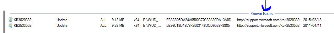

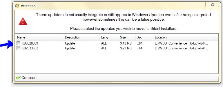

July 2, 20168 yr Author On 7/2/2016 at 4:20 PM, DougSchuess said: One of the prerequisites is currently moved to silent install, which means that SP2 can not be incorporated; instead the full list of patches must be used Not really. I get a box and if I mark the KB it will be moved to silent-install; if I don't mark it, it goes in a section at the bottom "Known Issues" BTW, the Convenience Rollup is NOT the SP2 Edited July 2, 20168 yr by Thiersee
