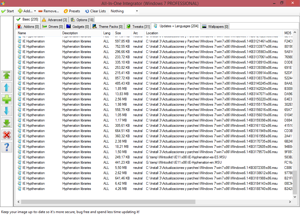

October 17, 20178 yr Hi! I was testing the latest version (1.5.4.12) and found a HUGE BUG. As I was adding updates to the list I noticed that about half the updates are treated as "IE Hyphenation libraries" instead of what thay really are. Also they are put under the "internet explorer" section instead of the "updates" Section. This is absolutely, totally and completely wrong! I attached a screenshot that shows the problem. I hope you guys can fix it ASAP.
October 17, 20178 yr I can confirm the bug! On my PC ALL the prerequisite are listed as KB3020369 and the updates as KB971033! PN sent to legolash20!
October 23, 20178 yr Took a while to hunt it down but I managed to fix it. It was caused because a missed out adding a 'true' boolean to delete non-empty folders.

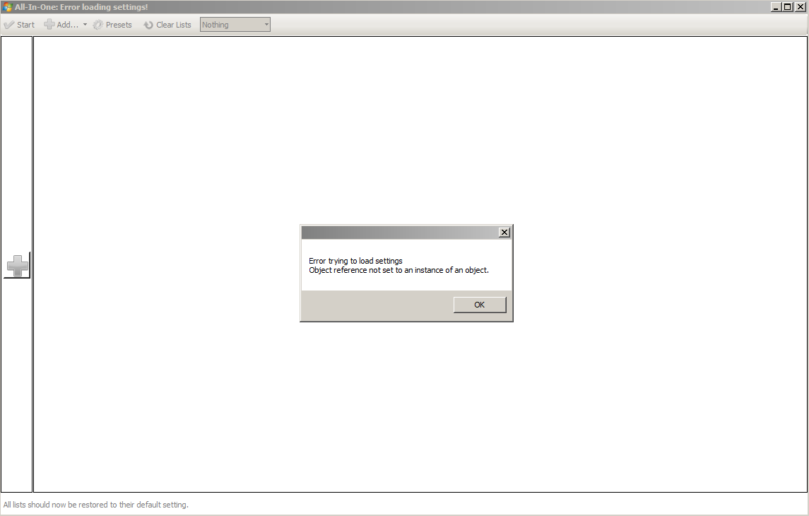

October 24, 20178 yr I didn´t get it to work... and this error is unknown to me. I enclose error_log.txt and Error.png error_log.txt
October 24, 20178 yr I've uploaded build 16 to the test area fixing six bugs since v12. That issue was caused by me removing an option. http://wintoolkit.co.uk/Home/TestBuilds
