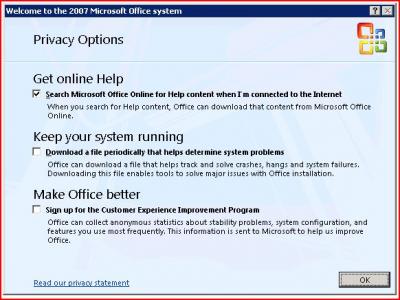

Posted June 10, 200817 yr Unattending or silently installing MS Office System, has now become easier than ever. There are two ways to unattend your setup:--> Option A (use it only if you got Office2007 thru SoftwareAssurance, which comes with activation stripped out).--> Option B is for all the others (retail/OEM/academic/trial/etc). Both are colored differently below.Option A:1. Ensure you have an actual enterprise/corporate disc & product-key.2. Notably, o2k7 uses setup patches (*.MSP) rather than transforms which previous versions used (*.MST). The below instructions will give you an MSP file, which is not accepted by non-corporate versions of o2k7. If you ignored point1 above, then you will end up wasting 15 minutes of your life which I'm not responsible for.3. Now at the command prompt, type: setup.exe /admin4. Choose the product for which you want to make a customization-patch.5. Then go through all steps in the customization wizard (to install the reqd apps & remove junk & change default settings).6. Be sure to have "completion notice" turned on & "suppress modals" turned off (this is to get to see errors, if any exist). Once you're done with testing, go thru the customization again to modify the MSP to disable completion notice & enable suppress modals.7. Save the resulting patch file in the same folder as o2k7 setup files.8. Now just execute this command (thru any method) for silent install: setup.exe /adminfile CUSTOM.MSPOr if you have the Office 2007 Enterprise VLK, you could even drop the CUSTOM.MSP file in the "Updates" folder & setup will pick it up automatically (without any switches being used). For this, ensure you have WindowsInstaller 3.1 already installed.*** For completely silent install, you MUST set the DisplayLevel to "none", either by MSP (accessible from step 6 above) or by xml, otherwise you'll get a confirmation dialog similar to the image shown in attachment below. (do this only AFTER testing, when you're sure it works)-----------------Option B:1. Go to the folder-path, "Office2007\Pro.WW" (or any ??????.WW folder for other editions such as standard/enterprise/etc)2. Modify "config.xml", or copy it to somewhere else & modify it, using my posted code below as a sample.3. If you modified it "in location", then setup will take up the changes automatically.4. Otherwise, place the modified file in the same folder of setup.exe, as custom-uA.XML5. This is the command to run setup with the customizations specified in custom-uA.XML: setup.exe /config custom-uA.XML7. This method is also a great way to make changes to the defaults itself, so that you dont need to keep changing it upon every new time you install it. The sample XML here, makes setup fully silent, cuts down features rarely used by me, and reduces install footprint of Office 2007 Professional from 721 MB, to 303 MB (of course you can always add/remove components later); I've also removed lines that I found useless from it, you might like to keep many of the default lines & customize them. Also, be aware that the XML offers a way to chain updates & install them before or after o2k7 setup, but then you'll lose control over reboot parameters. By default, o2k7 setup wont cause an auto-reboot, so no need of "/noreboot" or "Reboot=ReallySuppress" properties. I intend this XML to be used for clean installs, with no previous version settings or profiles to be migrated. Use "start /wait" for silent installs. This file is for the main suite, you can modify it accordingly for the other component products, the options are commented with double-slashes. I obtained the OptionIds from setup.xml files, in each component folder.Here's a tested/working config.xml file, to get you started with Option B:(you need to put in your own key, and configuration-Product can be obtained from your current xml)<Configuration Product="Pro"><Display Level="none" CompletionNotice="no" SuppressModal="yes" AcceptEula="yes" /><PIDKEY Value="BCDFGHJKMPQRTVWXY2346789B" /><USERNAME Value="0wner" /><COMPANYNAME Value="0wn Inc." /><OptionState Id="ACCESSFiles" State="absent" Children="force" /> //access<OptionState Id="OUTLOOKFiles" State="absent" Children="force" /> //outlook<OptionState Id="PubPrimary" State="absent" Children="force" /> //publisher<OptionState Id="AceRepl" State="absent" Children="force" /> //access db Engine replication<OptionState Id="CAGFiles" State="Local" Children="force" /> //Clip Organizer<OptionState Id="MSSOAP3" State="absent" Children="force" /> //SOAP toolkit<OptionState Id="OsaNonBoot" State="Local" Children="force" /> //new,open office docu lnks<OptionState Id="ProofingTools_1036" State="absent" Children="force" /> //french<OptionState Id="ProofingTools_3082" State="absent" Children="force" /> //spanish<OptionState Id="WISPFiles" State="absent" Children="force" /> //handwriting<OptionState Id="DocServicesFiles" State="absent" Children="force" /> //docu update util<OptionState Id="HTMLSourceEditing" State="absent" Children="force" /> //script editor<OptionState Id="DocumentImagingUtils" State="absent" Children="force" /> //scanning,ocr,indexing<OptionState Id="OISFiles" State="absent" Children="force" /> //picture manager<OptionState Id="OSESupp" State="absent" Children="force" /> //sharepoint support<OptionState Id="QueryFiles" State="absent" Children="force" /> //msQuery<OptionState Id="VisioPreviewerFiles" State="absent" Children="force" /> //visio viewer<OptionState Id="XDOCSFiles" State="absent" Children="force" /> //infopath<!-- These are additionals from Enterprise RTM<OptionState Id="GrooveFiles" State="absent" Children="force" /> //groove<OptionState Id="OneNoteFiles" State="absent" Children="force" /> //onenote<OptionState Id="RefIEBarFiles" State="absent" Children="force" /> //research explorer bar<OptionState Id="WebDriveFiles" State="absent" Children="force" /> //hosted webs<OptionState Id="VBAFiles" State="absent" Children="force" /> //VB for applications<OptionState Id="OfficeDigitalSFiles" State="absent" Children="force" /> //vba certificates--></Configuration>The procedure is same for all other editions of Office 2007. The above is just a working sample, you'd need to put in an appropriate key & modify as per your needs.If you downloaded a single SETUP.EXE (500-MB?) from MSDN, then you might need to extract it to some folder, to get the installation source.setup.exe /extract:D:\o2k7Courtesy: prathapml from MSFN
