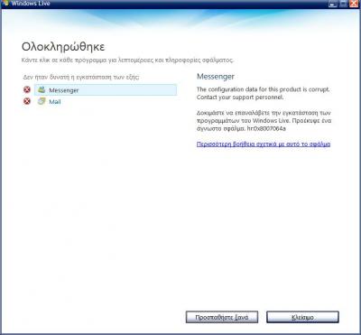

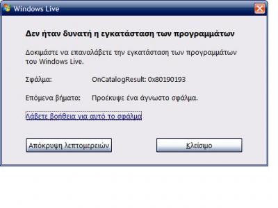

March 20, 200916 yr Thanks for addon but I have an unistall problem. I'm trying to unistall it and I install the greek version but I get errors.... Why is that happening? Please help me!!!!
March 20, 200916 yr Thanks for addon but I have an unistall problem. I'm trying to unistall it and I install the greek version but I get errors.... Why is that happening? Please help me!!!!well can you give me a picture of the error it uninstall fine on my pc
