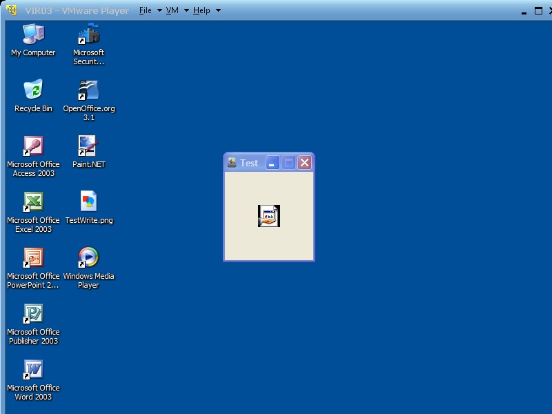

I just integrated this and when I did an install I get a tiny window pop up that says "Test" in the title bar and has a sharing icon in the middle of it.
Any ideas?
EDIT: Worse still it has appeared after install once the desktop has appeared and the window won't close! In fact, the window pops up every time you run DSI and won't go until you quit the program by right clicking the on taskbar icon. Also there is a file on the desktop called "TestWrite.png"
Here is a screenshot.
Edited by Zoom7000
Any ideas?
:blink: Oops... I must have been sleeping when I compiled that code. :blush: I included some code that was going to help me combine icons together and didn't realize that the code had it's own GUI that it created! I've removed the "offending" code from DSI and uploaded v5.3.7.1. It's in the first post! Thank you for reporting that and I'm sorry about that....
