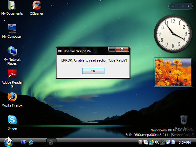

still getting this error
Error: unable to read section "live patch"
was this fixed.
When do you get this error? Cause it doesn't occur during installation....
and i also had the theme problem.. will try again with the theme fix..

  • I am still getting this error: I used XPtsp_v3.0.0.26_GUI.exe and selected the following options: 1.Integrate in a Windows Xp Source (Offline Mode) 2.Chose MSDN XP SP3 + XPSP3_QFE_UpdatePack Post-SP3
during startup since that live patcher runs at startup( xptsp.exe /AUTOPATCH..shows in msconfig) and even when u run it from the cpl ..i also get the error.. am not sure y i am getting this .. is there any log file created.. maybe its conflicting with some addons..??
Also when i looked at the xptsp.ini file there is no live.patch section, but there was a "livepatch" so when i changed it to live.patch another error came up this time it was looking for live.replace.
just to make things clear i cud be making a mistake.. i just need that gui addon right or do i also have to intergrate the live patch addon
The only place that "LivePatch" appears is in the i386\XPtsp.INF file. The XPtsp.INI is stored in i386\XPtsp.CAB in the i386 folder. I've modified the INF section labeled LivePatch to LiveInstall to try to avoid confusion between the 2 files....
I've modified the script to resolve the filenames at the beginning of the script instead of at several points in the script. Not only should this resolve this, but it should make it easier for me in the future....
................Huh? Live patch addon... what's that? The GUI should be able to build the INF/CAB file combo and place it into a i386 source without problem. I can't recommended using Bober's add-on along with the GUI. It may work, I'll grant you that, but you may have problems doing so. Then again, you may not have problems.... I don't know.
If you're asking whether you need the INF/CAB combo in your XP source folder, it's purpose is to provide repatcher abilities post-installation. Naturally, backups aren't available for this situation.... If you're not asking that question, then you'll have to explain to me what you're asking.....
uxtheme.dll was previously patched with Zacam's patch. This disc worked fine before using the GUI. :|
Sorry about that! The problem (which I didn't foresee) has been fixed in the GUI. Are you needing a virgin copy of SP3 UXTHEME.DLL?

the error tip i captured
I'm sorry about that. That bug is among the list of things I've either fixed or altered in v1.4.6.12. I'll post the newest version later today.
