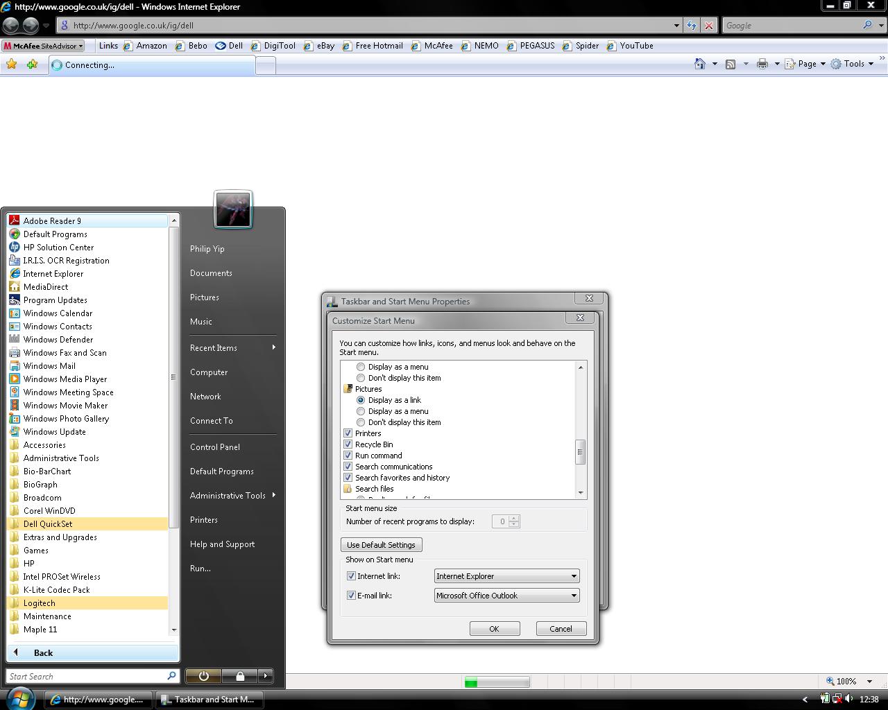

Upgraded RAM on my Dell Inspiron 6400 to 4Gb.
Finnally vista runs aswell as XP. Have got all stuff to work with vista tha I want (so far except for RecycleSMD)
Was wondering if this works under Vista Business Edition, it was really useful in XP as I don't really use the desktop.
Thanks for the XP one and Thanks for the Vista one (if there is one) If not I'll just add to the L.H.S. of the start menu.
