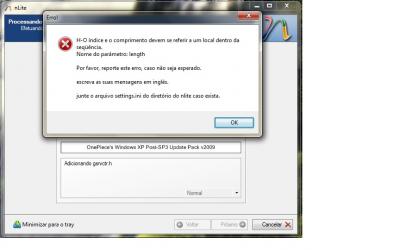

November 28, 200915 yr I had a erro whem a try add ie8 if nlite "H-O index and the length must be mentioned inside to a place of the sequencia. name of the parameter: length.
December 9, 200915 yr Hi spebph, uses the Universal UpdatePack/Addon Creator to create the IE8 AddOn, and you'll be OKCiao.
