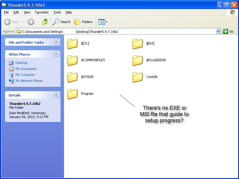

sorry, i'm new newbie. I successfully built few addon before. Recently, i just faced a problem.
I'am using universal extractor to extract an Thunder Xunlei5 installer (a chinese intenet download manager). But there're NO exe or msi file that lead to setup progress even though inside those folders.
The concept of Run "program.exe /S" is no longer work at all since there's no exe or msi file exist at all in extracted contents.
Following is the extracted content. Any expert guide me pls...
Posted (edited)
well it seem that you extracted the installer
you need a switch so can you upload the program or the web site and i will try to find the switch for you

Posted (edited)
Edit:
i found a version
Silent Switch is "/Silent"
i hope it works for you
The reason i extracted those contents, becos i wan to make some tweaks on it. Now I have done my tweaks, but i wan compress it again and there's no exe or msi to guide me to install progress...? Even though i compressed them, the setup.exe /silent not works at all becos no "setup.exe" inside extracted files. So How?
Edit: i'm using rarsfx method
Link: Official link
Edited by cute
