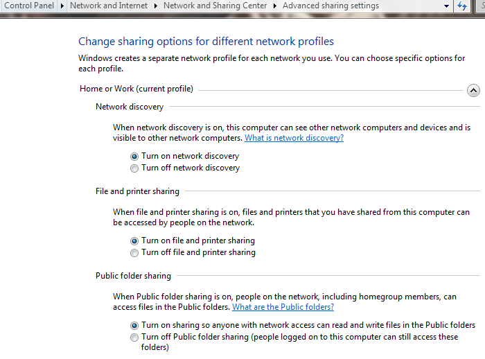

I don't see "Network and Internet\Network Connections" anywhere in Control Panel, I attach to this reply the Control Panel screen, the Internet Options subscreen and, because the upload size limit is a paltry 150 kB, in a subsuquent mail, the Network and Sharing Options subscreen.
