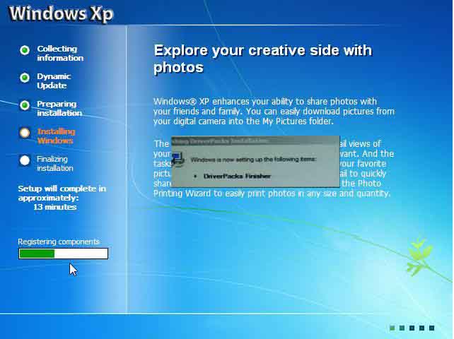

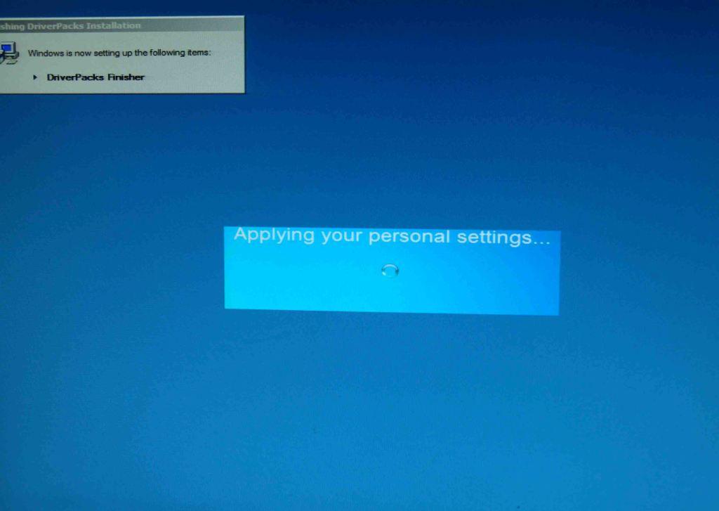

Posted April 28, 201014 yr i want to change the Driver Pack Finisher that start in the first log on of windows i want to switch it in the installing of windows time . how can i do that > Edited April 28, 201014 yr by rebi

June 8, 201014 yr Author - i am sure nobody like my question or request - any way if i you would like help me or another people the first step is be friendly response ...- i will test it .- so if i found it i will show in herei use %OEM%cmdlines ;; Generated by DriverPacks BASE 8.12.5;[Commands]"ROE.exe 937" ====>> the first time of login i see the picture i said .when time is good ? id didn,t andd app in cmlinei chang it too 300 ... how can i know 300 is between winch time of installing :questionmark: Edited June 8, 201014 yr by rebi

June 9, 201014 yr Author 1- RunOnceEx 2- EXACTLY when do you wish to execute the finisher? ===>> in the 13 minute Before installing Svpack ,if it is possible 3- exactly not in the first logon Edited June 9, 201014 yr by rebi
June 9, 201014 yr To answer your question...no. That's not possible.Not all the installers in every DriverPack are compatible with being installed at T-13, but all are ROE compatible.If you want to test, add the following line to \i386\svcpack.inf[SetupHotfixesToRun]%SystemDrive% & cd\ & Start /wait /separate /high "" DPsFnshr.exeI haven't tested this, but I'm 90% certain that it will fail.Don't blame me if this smokes your install, melts your ice-cream or turns your cat purple. Edited June 9, 201014 yr by Mr_Smartepants

June 13, 201014 yr Author Mr_Smartepantsyes you say it i remember , it is a bad problem , i see the dpsfinisher time in windows of my friend that created it he change this time to 13 minutes of picture that i showed it just this pic run , i did not know how can he do it ? but i think he use a program for doing that . i see just this pic in time something like this :
