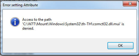

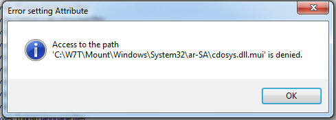

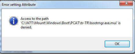

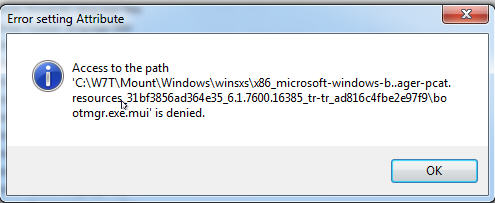

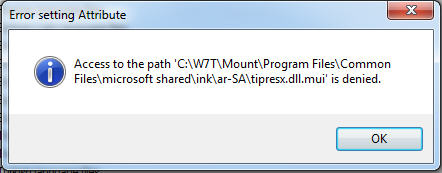

Posted
TNX legolash for replying,
I agree with Kels "8.5 does not close out properly".
I've made some other "Windows 7 Toolkit v0.8.5-10B" tests without success,
1) Remove components. Here bellow you'll find the error message I got for each language (~5 errors by n selected language).
2) I mount an image start configuration then I decided to cancel everything by close W7Tool with "Discard", the Install.wim was corrupted. Moreover, W7Tool process never end after closing (Exit) it.
3) I tested Rebuild (Check), the install.wim was downsized from 3.25GB to 3.15GB
May you please give more infos and issue regarding the W7Tool close buttons "Discard" "Save" "Keep Mounted" "Rebuild"
Regrads

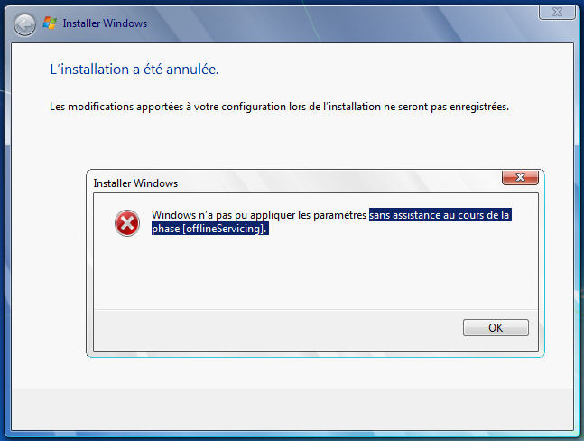

Posted
Hi legolash,
After integrating addons and selected tweaks to windows 7. The installation looks going right: Copy Windows files, Decompress windows atchives, Functions installation, Updates install and Finsih install (French translation).
When the "Finsih install" start, I got the here bellow error message: The Installation was cancelled. Windows Can't apply the without assistance parameters during the [offlineServiciing] phase(French translation). 3 times tested and got this error.
Regards

Posted
Hi legolash,
Regards
post-19145-048446700 1288111351_thumb.jp
Hello coucou! :rolleyes:
I think the trouble is about the "Autounattend.xml".
I give you later the new file because I've seen some changes needed!
Cheers
Posted (edited)
I see that your problem is solved!
In fact the trouble is made with "7Customizer" when the user don't use a password inside the "Autounattend.xml"!
It's needed to write:
<AutoLogon>
<Enabled>true</Enabled>
<Username>HEN</Username>
<Password>
<Value></Value>
</Password>
<LogonCount>9999999</LogonCount>
</AutoLogon>
Here with error:
<AutoLogon>
<Password>
<Value />
</Password>
</AutoLogon>
Cheers
Edited by myselfidem
