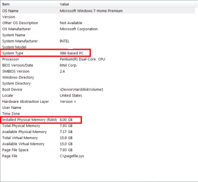

My Windows 32-bit has the full i had {3gb) showing know i have 8 GB RAM showing in the bios and in windows and they are Active
in the Internet often haunts the statement a 32-bit operating system can technically only managed a maximum of 4 GB of RAM. This is wrong and Microsoft is even evidence itself
The kernel of the 32-bit version of Windows 7 has only a lock, which prevents access to more memory. More dramatically is this lock in the 32-bit version
in the 32-bit version of Windows 7 from 4 GB usually only 3.25 -3.5 GB of RAM are usable:

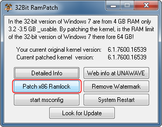

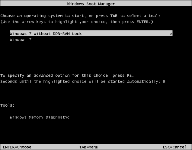

The Russian Programmers Group "staforce" has written a small program witch removes the lock in the kernel of the 32-bit version of Windows 7. "ICE Technologie" has translate this program into English. The program automatically makes a copy of the kernel file "ntkrnlpa.exe" and saves the copy as separate file "ntkrlICE.exe". Then the program removes the lock in the copied file "ntkrlICE.exe" and integrates the new kernel file as an extra boot menu entry in the Windows 7 boot menu. So then you have the option to start Windows 7 either as usual with the original kernel file "ntkrnlpa.exe" or with the modified kernel file "ntkrlICE.exe".
The text that appears in the boot menu can be found under "description".

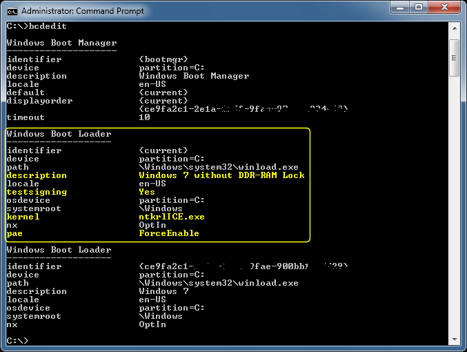

"testsigning = Yes" allows the patched kernel to start despite modification.
The copied and modified kernel is called "ntkrlICE.exe".
With "pae = ForceEnable" the address extension for the RAM is activated.
