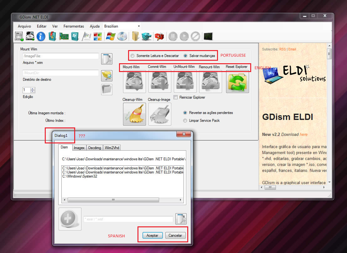

PS: Actually, now I just opened your program and I noticed that there are several strings that are not translated but they were not in the translation file. So in some places it's half Portuguese with some half English sentences and even a few Spanish ones, like the default "Aceptar" button.
Anything that can be done about it? Or you plan to leave like that?
It's not really a big deal, just a heads up :)
You Right, maybe is better translate all the commands, at the begining I left the real commands in English, like Mount-Wim, just for people who used the Dism.exe by console know what button do what command, that was my idea. So the Dialog defintly is a bug, :P.
