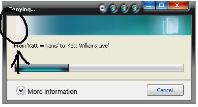

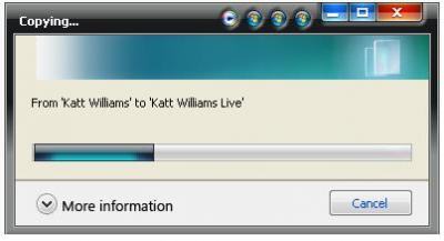

Drake Posted August 23, 2007 Posted August 23, 2007 (edited) its working fine, other than the file copy animation is smaller than the dialog box itself and it has a blank spot on the left side. here is a screen shot....also keep in mind that I'm using a window blinds theme so the progress bar is from the theme I'm using.Update:as for windowguy, if you want a different progress bar, I would recommend using a theme similiar to vista. as for me i'm still tweaking it....Update:its working fine, other than the file copy animation is smaller than the dialog box itself and it has a blank spot on the left side. here is a screen shot....also keep in mind that I'm using a window blinds theme so the progress bar is from the theme I'm using.Update:Fixed the gap issue, the box was too long so I shortened it, a lil bit.Update:ok I guess I didnt fix it, even when I resized the dialog box, it still show a gap as the picture I posted above, is there a fix for this? Edited August 24, 2007 by N1K Quote
