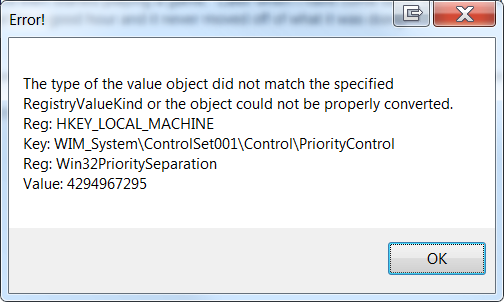

With this version of W7T 1.3.0.19a, I am having consistent errors and an occasional "lock up" of the whole program. The couple of times I have had the 'lock up', I have started the process and then started playing a game. Later when I have come back, the program is stuck somewhere (once in the updates section) and does nothing. I have let it set for a good hour and it never moved off of what it was doing.
As for the errors,
The type of the value object did not match the specified RegistryValueKind or the object could not be properly converted.
Reg: HKEY_LOCAL_MACHINE
Key WIM_System\ControlSet001\Control\PriorityControl
Reg: Win32PrioritySeperation
Value: 4294967295
It has done this to me twice in the same process and then the resulting image comes out as being corrupted. I have tried the entire process three times in a row. This did not appear to have happened with the previous alpha (1.3.0.18a).
Below is the screenshot of the error and my settings file.
settings.txt
post-11322-0-68168200-1314048429_thumb.p
As for the errors,
Value: 4294967295
