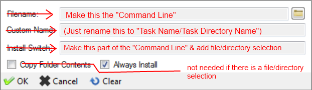

September 24, 201113 yr Author I don't know about Lego, but I'm lost. Could you give an example of your envisioned syntax, and also explain when in the install process these would run (beginning, end?) and what would trigger them?Cheers and RegardsIt is almost the same as what he has now. The main differences would be naming and how it works. (Pictures included.) Instead of "Filename", it should be named "Command Line" to be run from the directory the files are put in. The "Custom Name" could be better explained or renamed to "Task Name" since the task (when installed) and directory are named what is put in that text box. The "Install Switch" content can be moved to the "Command Line" and should be instead made to either select the specific install files (somewhat more complex) or just the directory all of those install files are in (probably easier as it is similar to what is already there. The "Copy Folder Contents" option can be removed if the file/directory selection is implemented.Hopefully that clears things up a bit better. Here is an example of what the options would beCommand Line: %Systemroot%\system32\wusa.exe Windows6.1-KB2533552-x64.msu /quiet /norestartTask Name: KB2533552Install Directory: G:\Win7\silent_installers\KB2533552The command line option could be done the same with inf files to be executed by rundll.
September 29, 201113 yr It is almost the same as what he has now. The main differences would be naming and how it works. (Pictures included.) Instead of "Filename", it should be named "Command Line" to be run from the directory the files are put in. The "Custom Name" could be better explained or renamed to "Task Name" since the task (when installed) and directory are named what is put in that text box. The "Install Switch" content can be moved to the "Command Line" and should be instead made to either select the specific install files (somewhat more complex) or just the directory all of those install files are in (probably easier as it is similar to what is already there. The "Copy Folder Contents" option can be removed if the file/directory selection is implemented.Hopefully that clears things up a bit better. Here is an example of what the options would beCommand Line: %Systemroot%\system32\wusa.exe Windows6.1-KB2533552-x64.msu /quiet /norestartTask Name: KB2533552Install Directory: G:\Win7\silent_installers\KB2533552The command line option could be done the same with inf files to be executed by rundll.I'm guessing i don't need to do anything for this request then?Detect KB2533552 and auto add it as a "silent install" would save a lot of people a headache I guess.Edit: I seem to be unable to integrate KB2559049 as well for some reaon. Edited September 30, 201113 yr by GieltjE

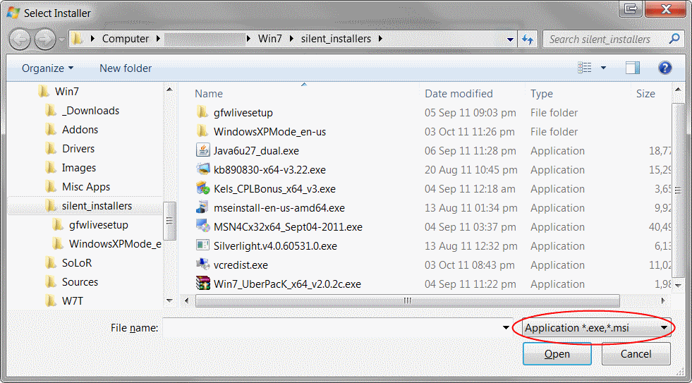

October 11, 201113 yr Author Tell me exactly what you did. Step-by-step with a few print screens please.I should be more specific. Yes, I can add the "hotfix" as a silent installer, however to do that, I must use a file dialog trick (using "*.msu") to get the hotfix to show up. (Attached screen below.) To correct for that, you probably should make the extensions '*.exe, *.msi, *.msu, *.inf' (if you have included support for the inf installer).No, I have not tested to make sure it works yet. However, that will be coming soon enough.

October 14, 201113 yr Author I've changed it so it will no longer work with the system32 method, you can however select msu files and it will install it. You don't have to enter syntax, it will auto install with /quiet /norestartJust to be clear, you have only set W7T to additionally work with MSU files right? (Still hoping for INF files.)
October 14, 201113 yr Tell me the full command you use for inf files to install your info files.Example:rundll32.exe advpack.dll,LaunchINFSectionEx .\<file>.inf,,,4Just to be clear, you have only set W7T to additionally work with MSU files right? (Still hoping for INF files.)On v50, you just select the msu file like you would an exe and msi. On the picture you attached above it shows "Application *.exe,*.msi" it will not say "Application *.exe,*.msi,*.msu" Edited October 14, 201113 yr by Legolash2o
