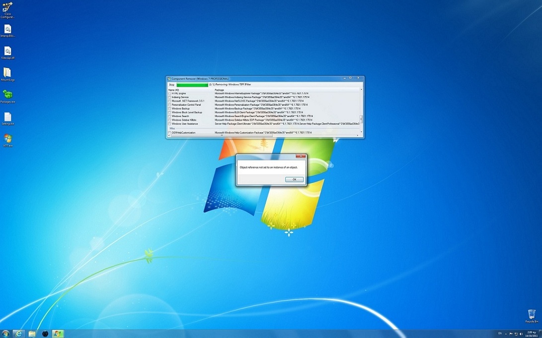

Posted October 13, 201113 yr Dear all,I get an "Object reference not set to an instance of an object" Message box during manual removal of components.Because I have tried it many times and with different order of removal of modules and with many fresh images, there is no specific module that causes that.My environment is Windows 7 64 bit and I manipulate a Windows 7 64 bit professional image.Any ideas?
October 13, 201113 yr When does the message appear? Is it always at the same place/stage? Can i have a screenshot of the error please
October 13, 201113 yr Author Actually when I am starting from scratch with an image I could get this message even from the very 2-3 removals but other times I get after I have removed several packages. Like the now. I have also noticed that when it will show for first time the message box then after that it will always pop it whatever removal I do.
October 13, 201113 yr Author I will replicate this from scratch tomorrow and I will send you the steps list.
October 13, 201113 yr I've managed to reproduce this error, consider it fixed. Just to add it doesn't effect the process so should be safe to install the image It will only appear if sample pictures have been removed.EDIT: v49 released hopefully fixing this error as well as other ones. Edited October 14, 201113 yr by Legolash2o
October 14, 201113 yr Author Very good version!!!!!!!!!!!! I haven't seen the error box not even once!!!! And this time I really pushed it harder. Very good work man.
