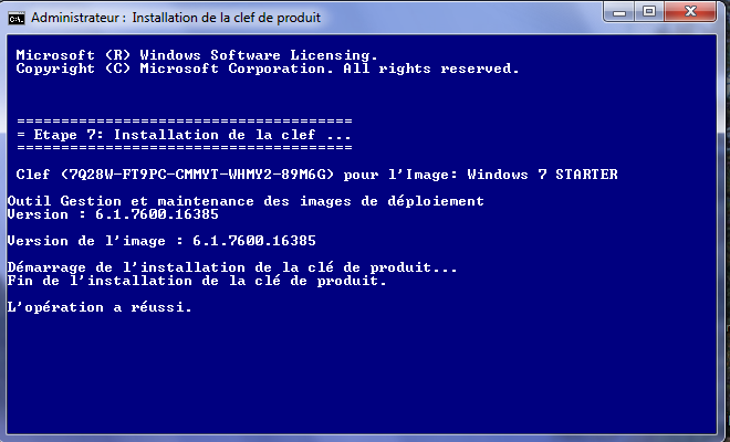

November 1, 201114 yr OK! Added Windows 7 STARTER default key. I made a new test and works. New batch files SetProductKey.rar (fr-FR/en-US)! Edited November 3, 201114 yr by myselfidem
