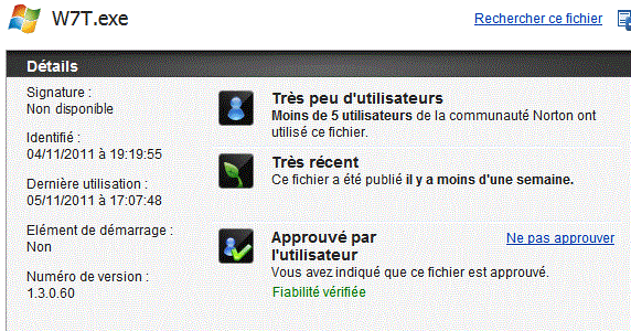

November 5, 201113 yr Oh. Really nice! I will do a test and said Norton to accept W7T.exe...But I don't like warning messages!RegardsP.S. Norton sucks IMO
November 5, 201113 yr Theres should be an option to report it as a false positive, try that Check the file with Norton on my computer and I've selected approved by the user...and W7T.exe works fine now! About xml creator, could you please change the order of the passes, like it is recommended?:1 - <settings pass="windowsPE">2 - <settings pass="generalize">3 - <settings pass="oobeSystem">Thanks and Regards
