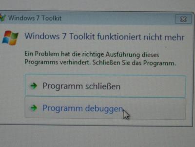

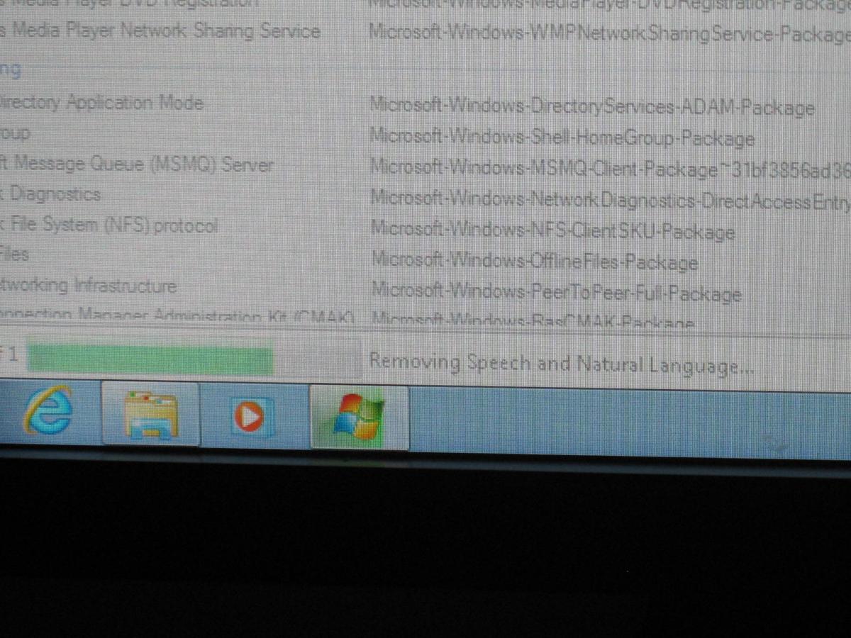

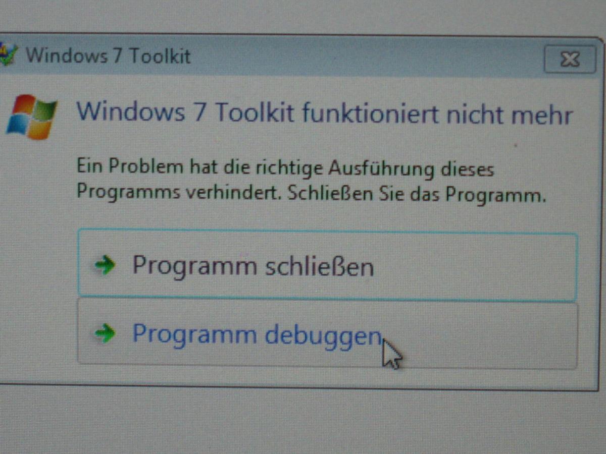

The same thing in my Win7 Toolkit appears. While speech and natural language removing it crashes ! The proggie wants to be closed or the debug modus. But when I take the debug modus nothing happens. and I must close the proggie and start again.
post-17491-0-43344400-1321137314_thumb.j
Here is the second picture.
post-17491-0-93528600-1321137519_thumb.j

I'm using a 64-bit Prof. version. For the second time the process of 7Toolkit broke at the same location. Look at my screenshots.
