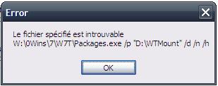

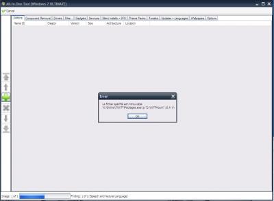

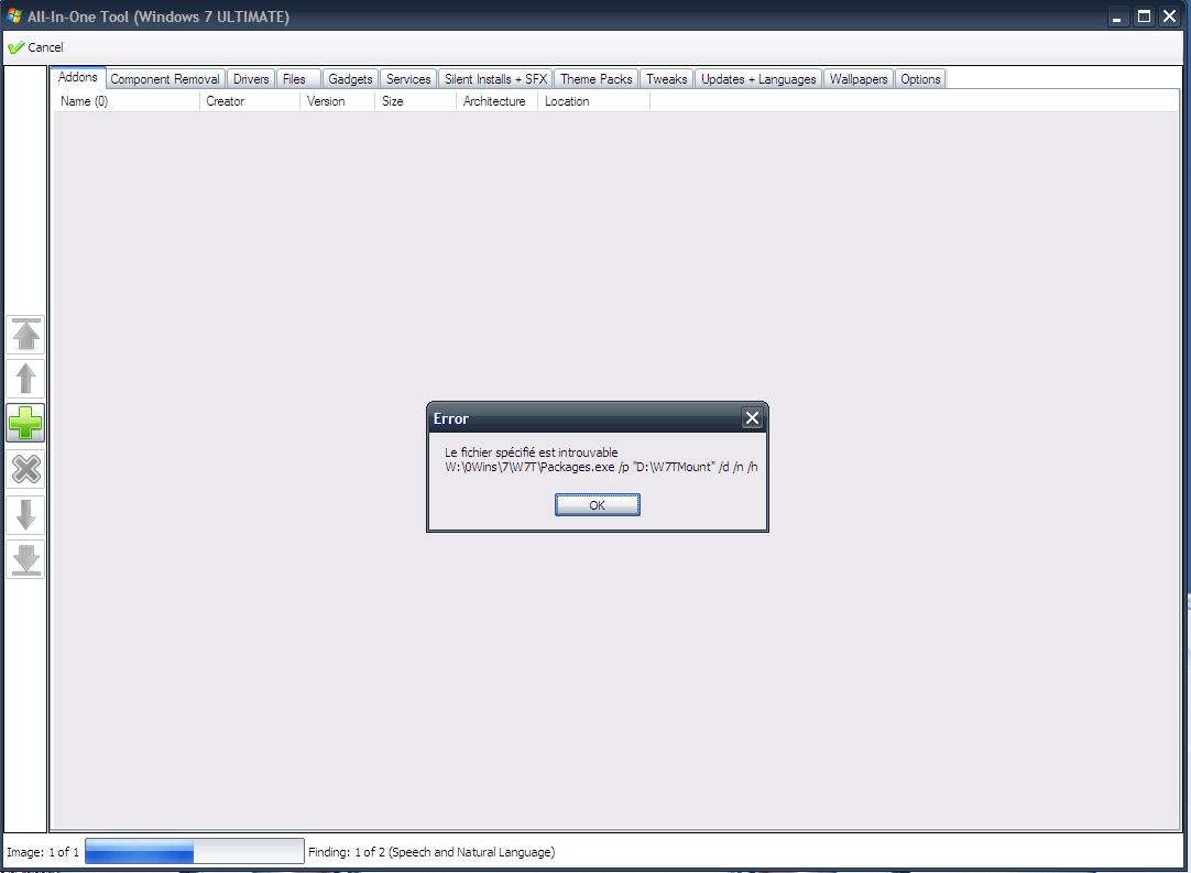

November 13, 201113 yr Author :prop:It works now!But I still have the "Packages.exe" file not being found error. :g:
November 13, 201113 yr Author But I still have the "Packages.exe" file not being found error. :g:I replaced W7T.exe with an older (1.3.0.61) version and the same error occurs!may be there is a problem in my Settings file.fAddons=fDrivers=fGadgets=fSilents=fThemes=fTweaks=fUpdates=W:\0Wins\7\Library\IE9fWallpapers=sAICommands=TruesAIOSave=TruesCheckForUpdates=TruesDLogging=TruesFreeRAM=TruesGroups=TruesHotkeys=TruesImagex64=TruesLastWIM=W:\0Wins\7\Ultimate\Sources\install.wimsmCheck=TruesAIOPM=TruesMountTemp=D:\WTMountsQuickMerge=FalsesmVerify=TruesSolDownload=W:\0Wins\7\Upd\sTransparency=95sTransparencyAll=FalsesW7TDISM=IdlesW7TExt=IdlesW7TPRI=IdlesW7TTemp=W:\W7TTempsShowAntiV=FalsesSkipDCheck=FalsesUploadLogs=TruesLastISOF=sMountLog=TruesUSBPrepLog=TruesWelcomeTab=FalsesDownloadTab=FalsesToolsTab=TruesRegistryLog=FalseI will delete the settings file and give a try.
November 13, 201113 yr Author When do you get that error? just after mount?yes! right after it mount the image before it tries to delete the Backup folder.

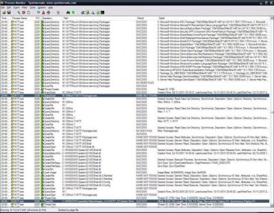

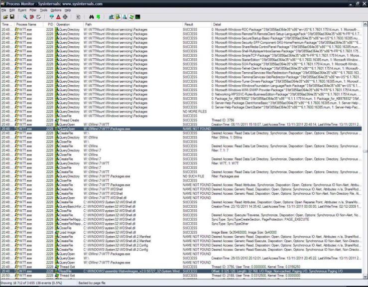

November 13, 201113 yr Author The first highlighted line is the first occurrence for the word:"packages.exe"The second highlighted line is when the error message appears.Try to use: W:\Win7\sources\install.wimsLastWIM=W:\0Wins\7\Ultimate\Sources\install.wimI was using the same folder for weeks, so I'm sure it isn't the cause.

November 13, 201113 yr I've removed packages.exe from W7T and copied the useful code from it, so you should not receive the error anymore.. Uploading a test version now...
November 13, 201113 yr Author I FOUND IT!!!During the whole nightmare I was only testing the new version of W7T on removing both "WinSxS\Backup" and "Speech Neutral Language" and only those things.I finally decided to choose none of these for removal and I chose only "Bitlocker Disk Encryption" as a try, and guess what! No errors and "Packages.exe" is really created in the same folder as W7T.exeSO IT IS A BUG.To reproduce the bug just select "WinSxS\Backup" and "Speech Neutral Language" for removal and see for your self.I'm gonna try each at time to see if the error occurs.
November 13, 201113 yr Author Yes! the error occurs even if I select only one of them for removal.PS: I did not tried yet the "...Test2" version.
