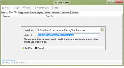

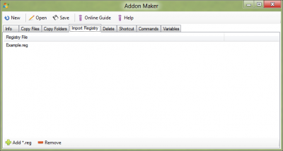

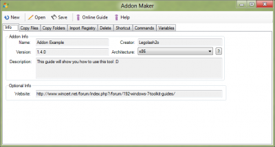

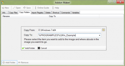

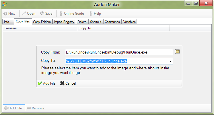

Legolash2o Posted March 30, 2012 Posted March 30, 2012 (edited) This tool lets you create addons for Windows 7 Toolkit, this tool has a lot of potential, more than people realize! Used correctly, this tool can have your progams pre-installed after Windows installation.This tool is the most complex, but you becomes very easy to use ones you get your head around it but this is not for the faint hearted. So good luck!Note: I will only be covering the basics!InfoThis is one of the easier screens and is pretty self explanatory and i'm pretty sure you can figure this out.FilesThis will copy file to the mounted wim image when someone adds this addon. So go ahead and click 'Add Files' at the bottom.1. Click the folder button and browse to the file you wish to copy.2. Select the destination, you can choose to a pre-defined area and then add '\\filenameyouwant.exe'You can also type it in manually like 'C:\Windows\System32\RunOnce.exe' but you would not type the beginning 'C:\' so it would be 'Windows\System32\RunOnce.exe'FolderSame as above, select the folder you wish to have installed and then select where you want the folder to go.Add any *.reg files you wish to have installed or required for your addons, some users use a program like InstallWatch which tells you what registry/file changes where made to your computer during an installation. You then export the registry changes and import them here.Delete FilesType in the location of the file you need deleting for example 'Windows\System32\Example.exe'ShortcutsThis is where you can create shortcuts for the program you made. You can just copy and paste a pre-existing shortcut from an installation in the 'File' tab and tell it where it needs to go i.e. Desktop.You don't need to use 'Icon' if the exe you pointed too already has one. Also 'Arguments' is mostly left blank as you don't need anything like /s /q /quiet, etc..CommandsThis is for commands which you want to run after Windows has been installed.It doesn't seem like it has alot of potential but trust me it does! Used correctly, you can do anything with this tool.As mentioned above you can use InstallWatch to record what an installation does, so that you can use that information to make an addon which then has that program pre-installed when you have Windows installed.Any questions about this tool (not bugs) just post in here and i will try to reply. Edited March 30, 2012 by Legolash2o Ali Sahandi, geodasoft, bawarmk and 6 others 7 2 Quote

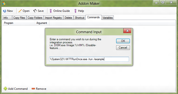

Kelsenellenelvian Posted August 30, 2012 Posted August 30, 2012 Suggestion? Convert the au3 to an exe and just run it under the silent section? Quote
NewOne Posted August 31, 2012 Posted August 31, 2012 hii dont see a silent selection. And i converted the .au3 to an .exedo you mean in command section likeRegion.exe /run if yes what is the right command to start it? Quote

arkangelo22 Posted September 1, 2014 Posted September 1, 2014 Hello to see whether you are so kind to help me when you added the .reg of the program i'm going to the path HKEY_CURRENT_USERSoftwareUltraIso (in this case being the program of the example the Ultraiso)i right mouse button and chose export the .reg and this .reg is that must be added to the Addon Maker? Quote
Ibnalrasool1379 Posted September 2, 2014 Posted September 2, 2014 Hi. Can you make some addon for me? Quote
Legolash2o Posted September 3, 2014 Author Posted September 3, 2014 Good tutorial my frnd but I want to ask you that how can ii make a google chrome addon, Ihave tried but not succesful i had tried using a batch file scriptThanks in advanceThe best of using the Silent Installer option. Hello to see whether you are so kind to help me when you added the .reg of the program i'm going to the path HKEY_CURRENT_USERSoftwareUltraIso (in this case being the program of the example the Ultraiso)i right mouse button and chose export the .reg and this .reg is that must be added to the Addon Maker?Yeah, that's pretty much how you do it. Once exported, just add that reg file to Addon Maker and it should do everything else on its own. Hi. Can you make some addon for me?I don't tend to make addons. There's a small team of people who makes addons. http://www.wincert.net/forum/forum/180-win-toolkit-addons/ Theres a topic at the top for addon requests. I have no idea how often it gets checked but it's the best place to start. Ali Sahandi 1 Quote
