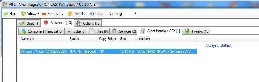

August 22, 201212 yr Big issue - VirtualPC Update: Windows6.1-KB958559-x86-RefreshPkg (msu / cab) added to "Updates + Languages" goes automatically to "Silent Installs + SFX"
August 22, 201212 yr On 8/22/2012 at 12:57 PM, MAXtoriX said: Big issue - VirtualPC Update: Windows6.1-KB958559-x86-RefreshPkg (msu / cab) added to "Updates + Languages" goes automatically to "Silent Installs + SFX"It's not a bug, it's a feature! Have a look here (Post #11)MfG, Thiersee
