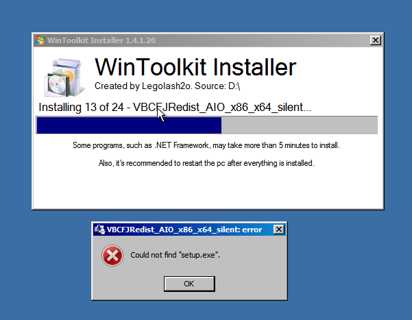

March 10, 201312 yr hi ricktendo, i tried to used your aio with WinToolkit last version (1.4.1.20) placing the installer at silent installer section using /y swtch and at the end of windows instaltion i got this error:if hit ok and check late the package wasn't installed. any suggestions? btw Windows 7 Sp1 enterprise x64 with updates til feb 2013regards Edited March 10, 201312 yr by BiuS
March 10, 201312 yr Might be a gui sfx problem http://support.microsoft.com/kb/185294Anything u or i can do to avoid this error?
March 10, 201312 yr Author Maybe installing it after login BTW that KB article says it "sometimes" happens, so it may not happen every time
March 10, 201312 yr Maybe installing it after login BTW that KB article says it "sometimes" happens, so it may not happen every timeWell tried 2 times to make sure was not my mistake. but anyway thanks for the support. i will try other solution, since i would like to integrate this installer into my build instead of install manually after the system is installed.

March 19, 201312 yr Can you think of a reason why this installer doesn't work with SFXMaker anymore? It's not SFXMaker version to blame, I tried both the current one (1.3.1) and also the previous 1.2.1. I'm trying to apply the /ai silent switch to it via SFXMaker, but it doesn't work, both via Win Toolkit's first logon, both on live system (same ''setup.exe'' error). You have the error attached. However, if I use the /ai switch via Run Arguments on a live system, everything is working fine. The reasons why this is happening are beyond me... this has never happened in the past. LE: To be more precise, when added via SFXMaker, the setup files don't get extracted /unarchived / uncompressed on the local disk (doesn't get to this ''first'' stage), while via an argument on a live system they do get extracted, and after that everything is ok. Maybe you changed something in the last ~ month that generated this weird behaviour. Maybe this, as it's related to the ''extract'' stage. Edited March 19, 201312 yr by RicaNeaga
