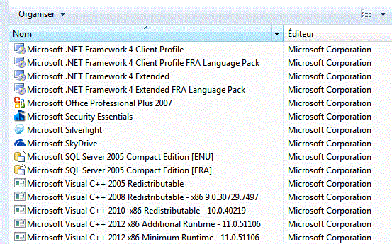

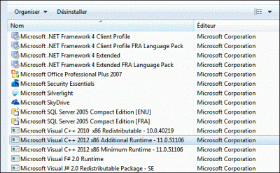

I can confirm there is a trouble using Oracle VM and only Microsoft Visual C++ 2005 and C++ 2008 (x86) aren't installed.
BUT on my computer all are installed like I wish ! This is strange because on Windows 7 x64 all works fine on Oracle VM.
Using: Silent "No GUI" SFX alternative v2.9
Cheers and regards
